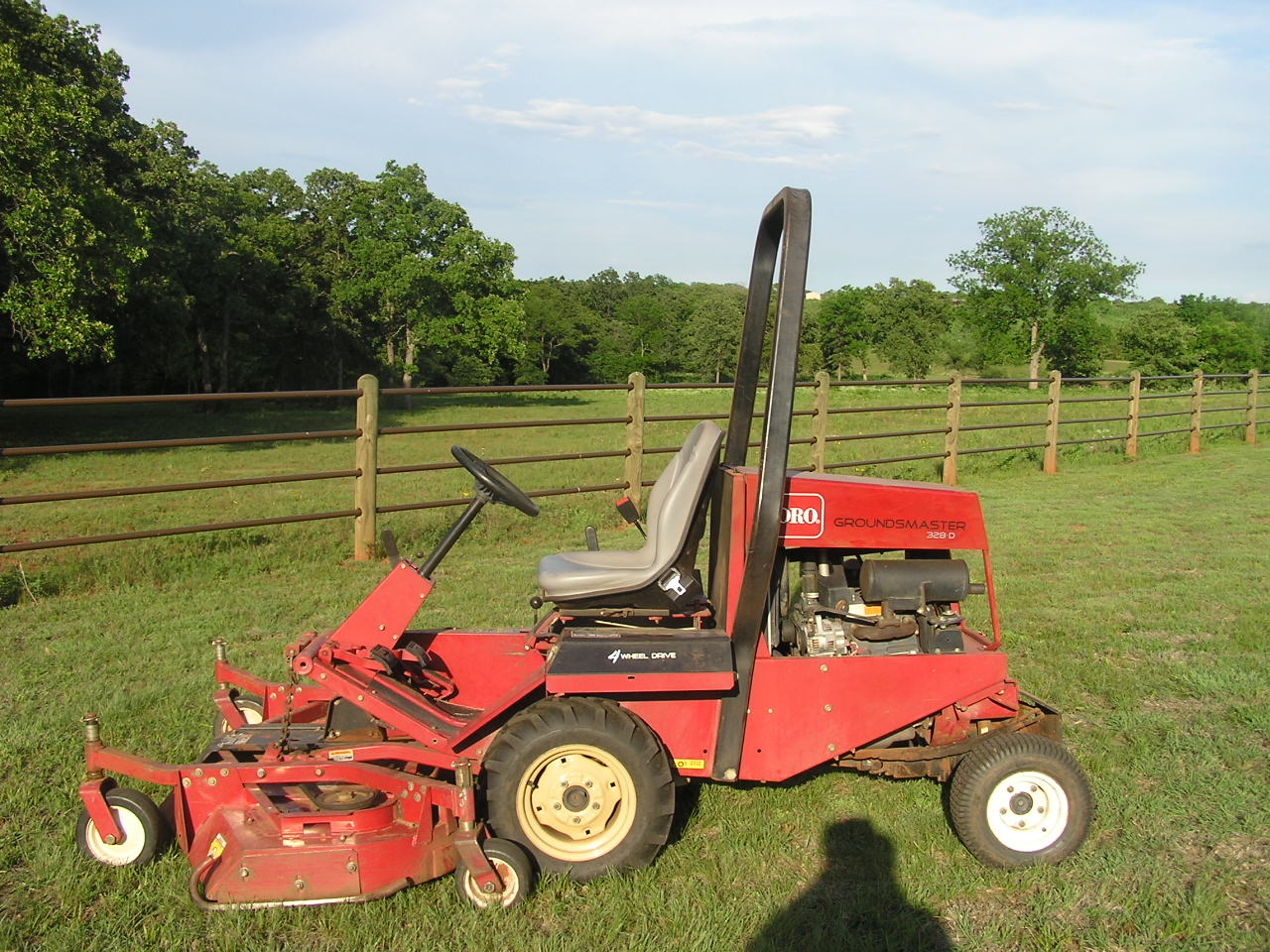

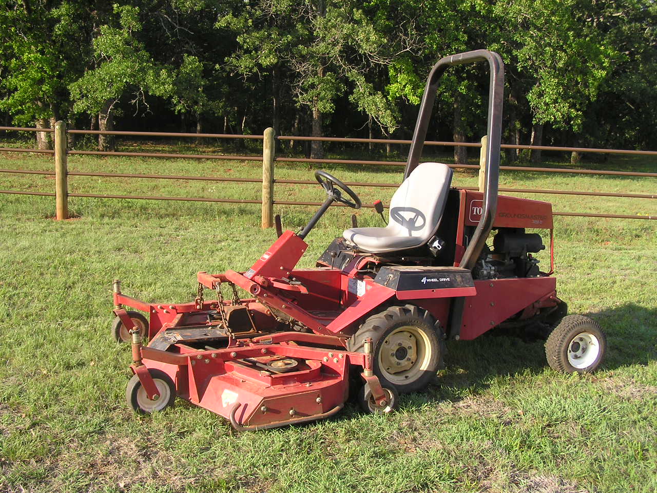

No clue, but am interested in why you want to use a flail on the front instead of the rear which is more of the standard and more flexible with other tractor usage?
Since he didn't answer, my guess is he is mowing a vineyard or orchard, since it is a narrow tractor.
My other guess is that you have never mowed with a machine with an out front deck:

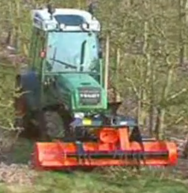

>I am interested in why you want to use a flail on the front instead of the rear which is more of the standard and more flexible with other tractor usage?
When chopping branches from winter/summer pruning in orchard with flail mower at back - it quite often happens that apple tree branches pierce tires.
No such problem when flail mower at front.

Tried today KUHN flail shredder BKE 180 REV with New Holland tractor (75HP) - mounted at front.
It worked ok - chopping 2-3 cm dia. branches. I`ve driven quite slow though.
Worked with 75HP - will work with 100HP.
Regards.
My other guess is that you have never mowed with a machine with an out front deck.
Yes, you are correct. I do understand the virtues of the mower type you posted. However, a 97 HP tractor is a different piece of equipment altogether. I have never performed large scale mowing requiring a 97 HP tractor with a front mounted mower, which is why I asked for specifics. My mind is still searching for the type of operation requiring something like this or how a front mount would be better than a rear mount on a tractor such as this with the PTO RPM mentioned and mower speed modification required. Just a learning experience for me.
Or maybe the OP just wants what he wants, which I can certainly relate to as I do similar sometimes :).
Makes perfect sense to me. He's mowing/mulching prunings from orchards. Material like that sucks to drive over. It gets tangled up under tractors and ends up tearing off hydraulic lines, etc. By mowing before driving over the material you eliminate that problem. You clear yourself a path so to speak.

Flail mower I want to buy and front/back config. of it:
