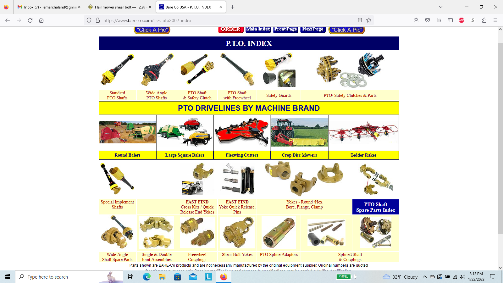

PTO shafts are available in a multitude of configurations with and without shear bolts.
For an interesting read you can browse this catalog,Bare Co USA - P.T.O. INDEX
