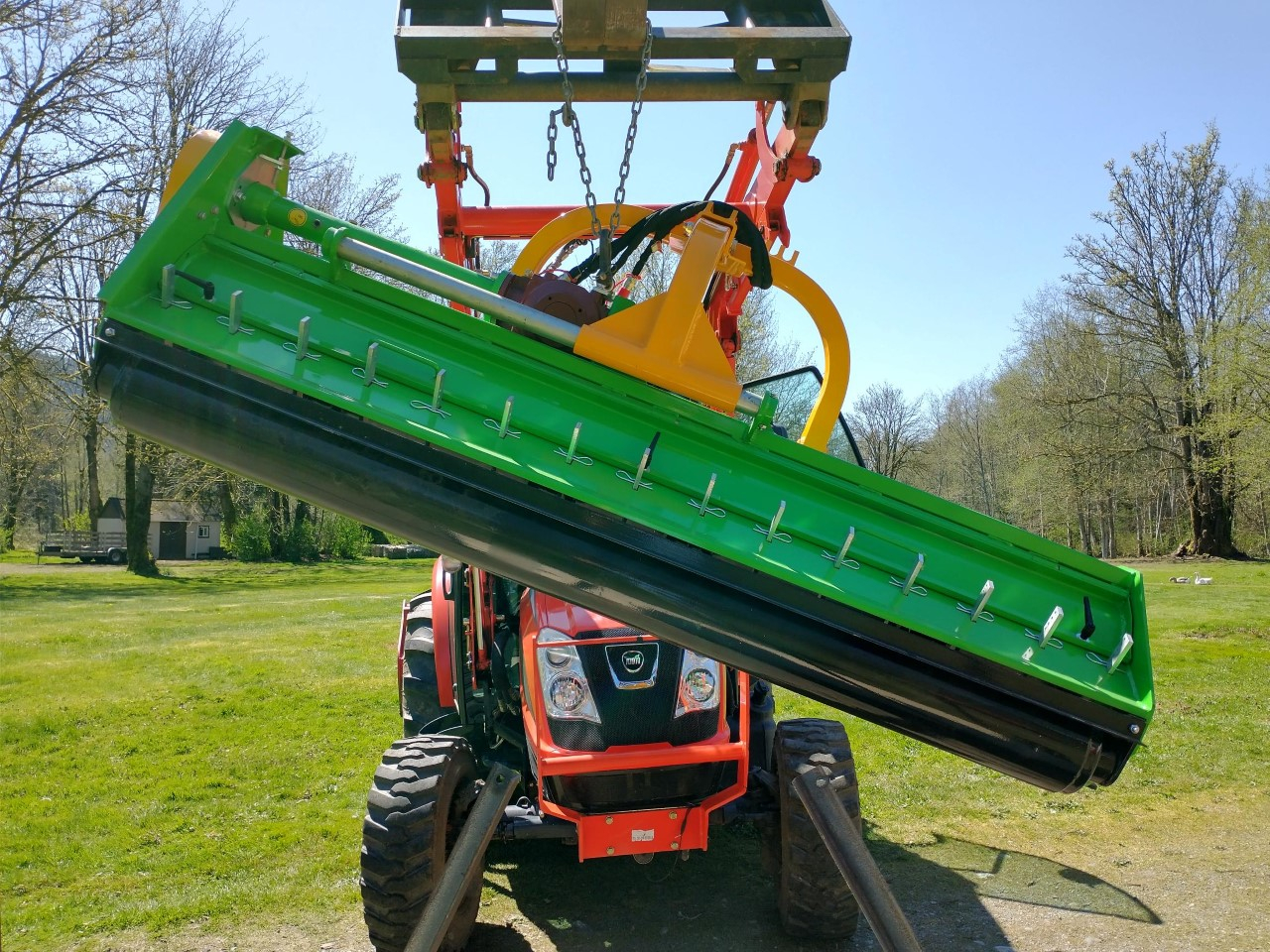

Look at what my Kioti caught (a 1,200 pounder)!
MXZ220 arrived. I made the [bad] assumption that the lifting hook was a balance point with the carrier centered. In fairness to the manufacturer, there's no mention of using this hook for extracting out of the crate (or of the hook at all; but, I know a lifting hook when I see one!:LOL:): there's also no documentation on how to un-pack from the crate. Anyway...
Other than cutting the PTO shaft and installing the front bumper/guard* there was nothing else to be done in order to get it hooked up and running. I probably spent less than 2 minutes setting the operating position and then it was all good (I've read of people struggling to get flails to cut well; I was expecting to have to mess around, but that didn't turn out to be the case).
* I managed to bend it after catching in on my fence (going backwards)! Promptly bent it back (and intentionally so) by going forward and brushing against a fence post. (y)
It's a total beast, in every sense of the word. Nothing here would support any notion of this as being a [cheap] toy!

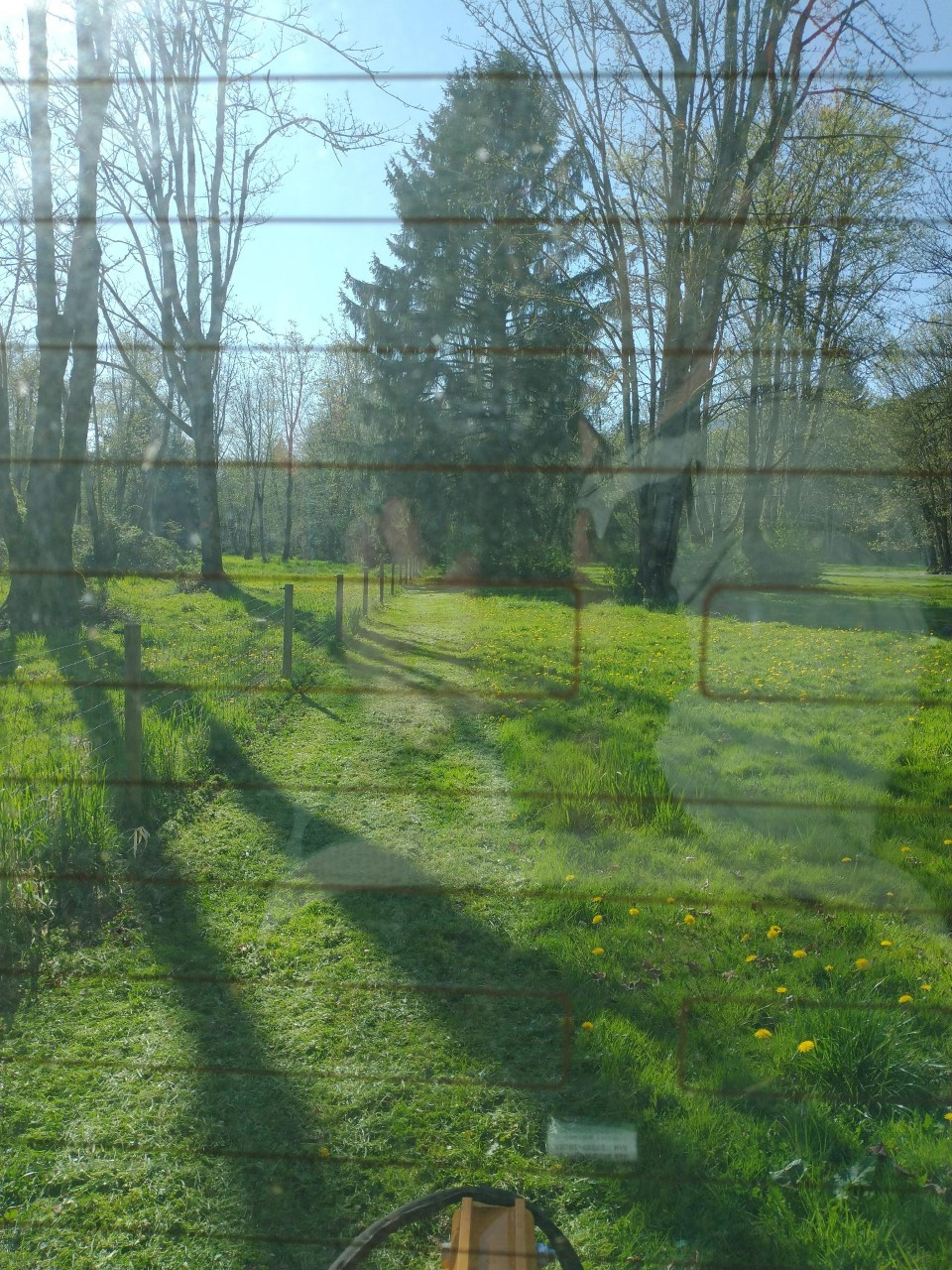

Initial run. Grass less than a foot tall. Plenty enough small branches around to evaluate its performance for dealing with woody debris. I was totally surprised at/impressed with the grass cutting.
With the RC I'd have the typical tire tracks of smooshed grass. With this flail there's scant traces of dandelions left after passing. NOTE: this is the "homestead" side of the property; on the other side of the fence is the "wild" side, the side that I'll be moving to to really put this thing into it's more typical operating environment (more trees to dodge/mow around; more wood debris; taller grass and some larger open grass areas etc.).

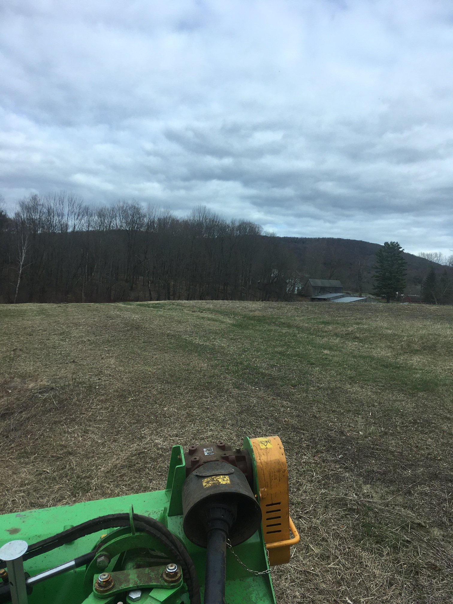

I can now give a report on the BCRM175 I recently bought. I agree with DieselBound on how much of a beast this mower is. With the ditch bank mower, I recommend finding a helper for assembly since things are so heavy and a bit award to handle. The tolerances for the swing arm linkage are pretty tight and require some wiggling to get things lined up. There is a pipe on the turn cylinder that got bent during shipment and leaked. I contacted Jack and he sent the pipe and new fittings right away. They were here in less than a week after I called. I did put an o-ring in on one side of the valve as it still leaked.
I did use the mower without the tilt cylinder, you can lock the mower so it doesn't tilt. My 5075e hydraulics are a bit touchy so I have to really be careful side shifting so the mower didn't slam. If you can't adjust your flow on your remotes, I recommend installing some flow control valves on all the mower hydraulic lines if you have fast hydraulics. The tilt cylinder has 1 flow control valve on the retraction hose. I adjusted the skids and drum to the middle hole, out of 3 positions. As DieselBound said, this thing rides along the ground really well without scalping. Side shift is a luxury I didn't want to live without.
The hammers chew things up really well. The field I mowed was all the winter killed growth from last summer, so nothing too heavy. It was matted down but the mower did a decent job, but it really sucked it up if you went against the way it was laying. I did mow quite a bit of stuff that was up to about 1.5" without any bogging down. I went slow to allow the hammers time to do their thing. I had to go over the thick brush a few time from different directions as the front guard would just bend things over the first time and not chop it up completely. Rocks were found and a few destroyed without any noticeable damage to the hammers or roller.
I have used a few different flail mowers over the years, notably a John Deere 25A and a Land Pride 4188. The 25A was a good grass machine, but went through belts if you were mowing tall thick stuff. The bearings on the roller were also a weak point and needed replaced almost yearly and weren't the easiest to replace. The 4188 was a beast and would only slow down in wet thick grass, but didn't follow the ground quite as well as the Nova seems to.
So far, I'm impressed. Time is the ultimate test as with all things. For the price and customer service, I'm not sure if there's a better buy right now with flail mowers.
