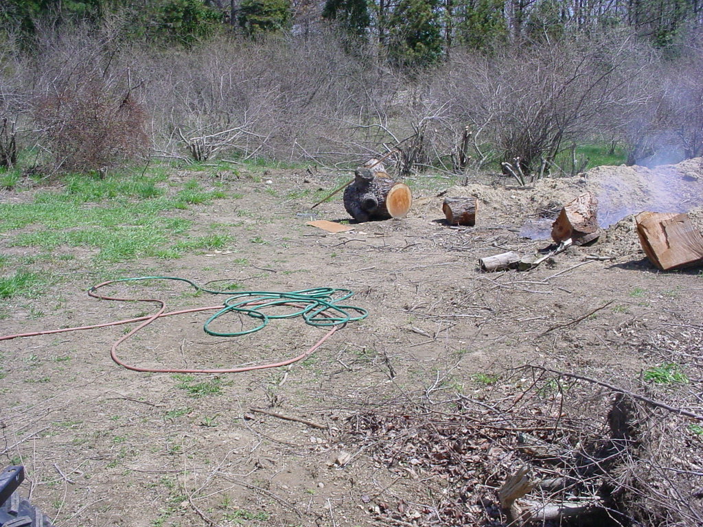

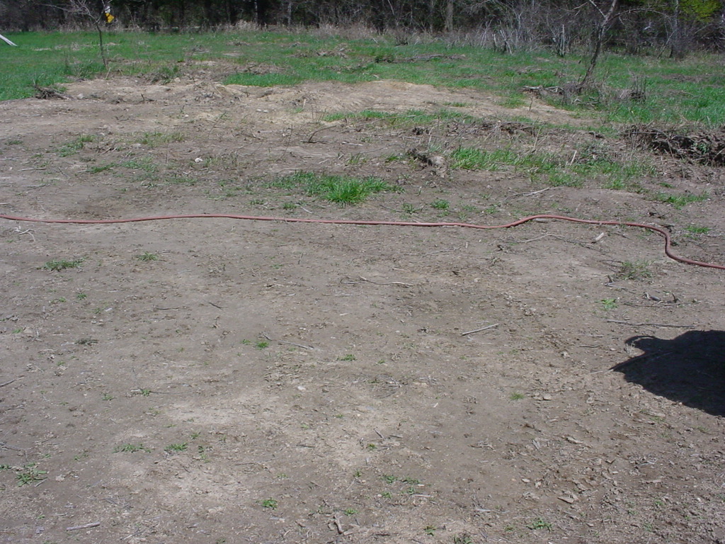

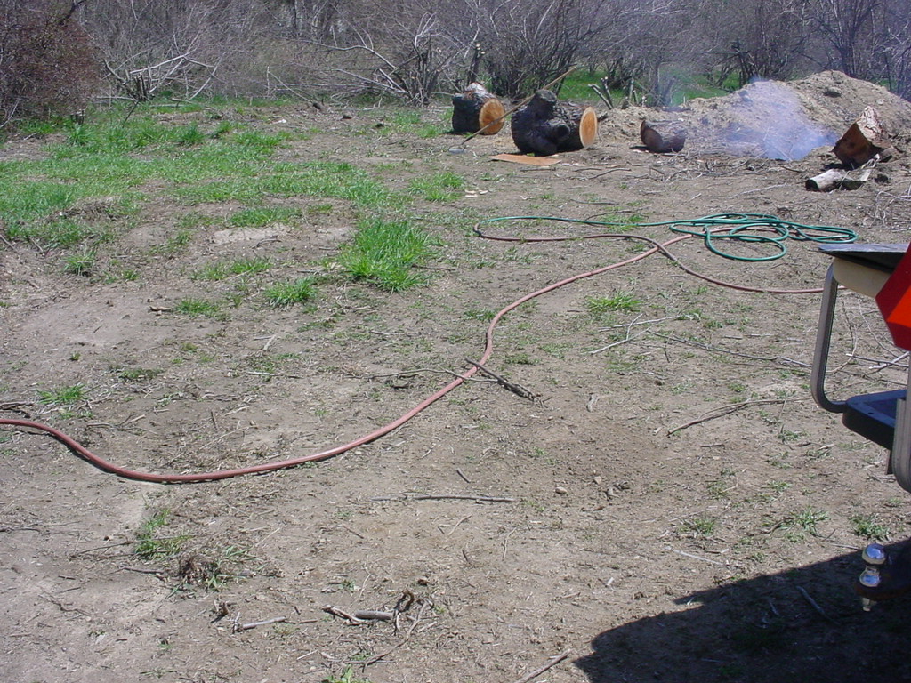

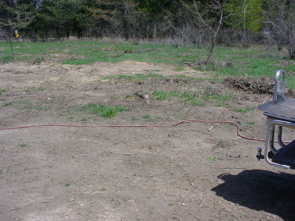

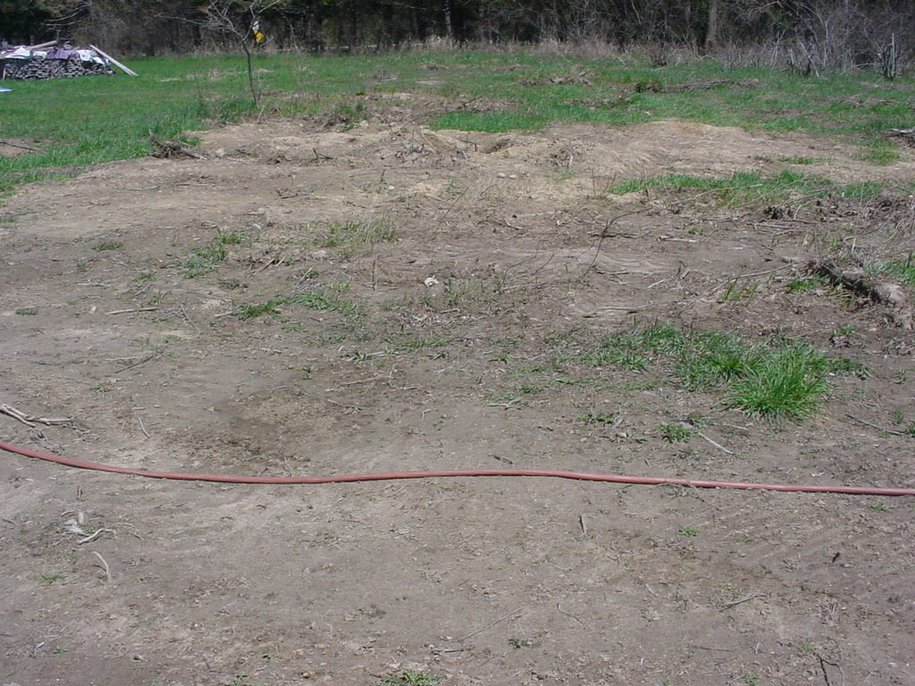

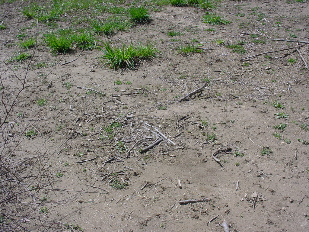

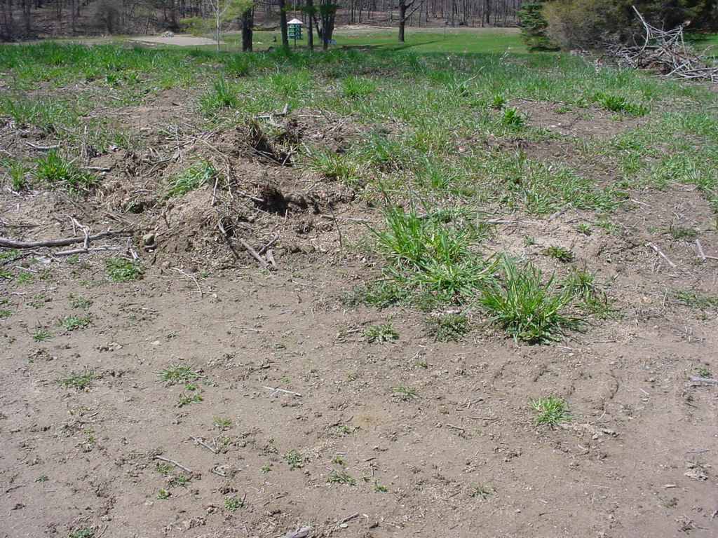

So what you are saying is it's ok to use the flail mower a foot or two off the ground?
The reason I ask is that I'm not done clearing the stumps, roots and limbs yet and the grass is already starting to grow and the ground is nowhere near level to cut with a mower.......
I suppose you could raise it but flails are really designed to be on their rear roller. If the grass is very high, I just slow down.
Sure. The rear roller does in fact ensure a more even cut, but the main purpose is to take the weight of the mower off the hitch. There's nothing wrong with occasionally cutting in the raised position, but I wouldn't do it on a regular basis. Too hard on the tractor.
