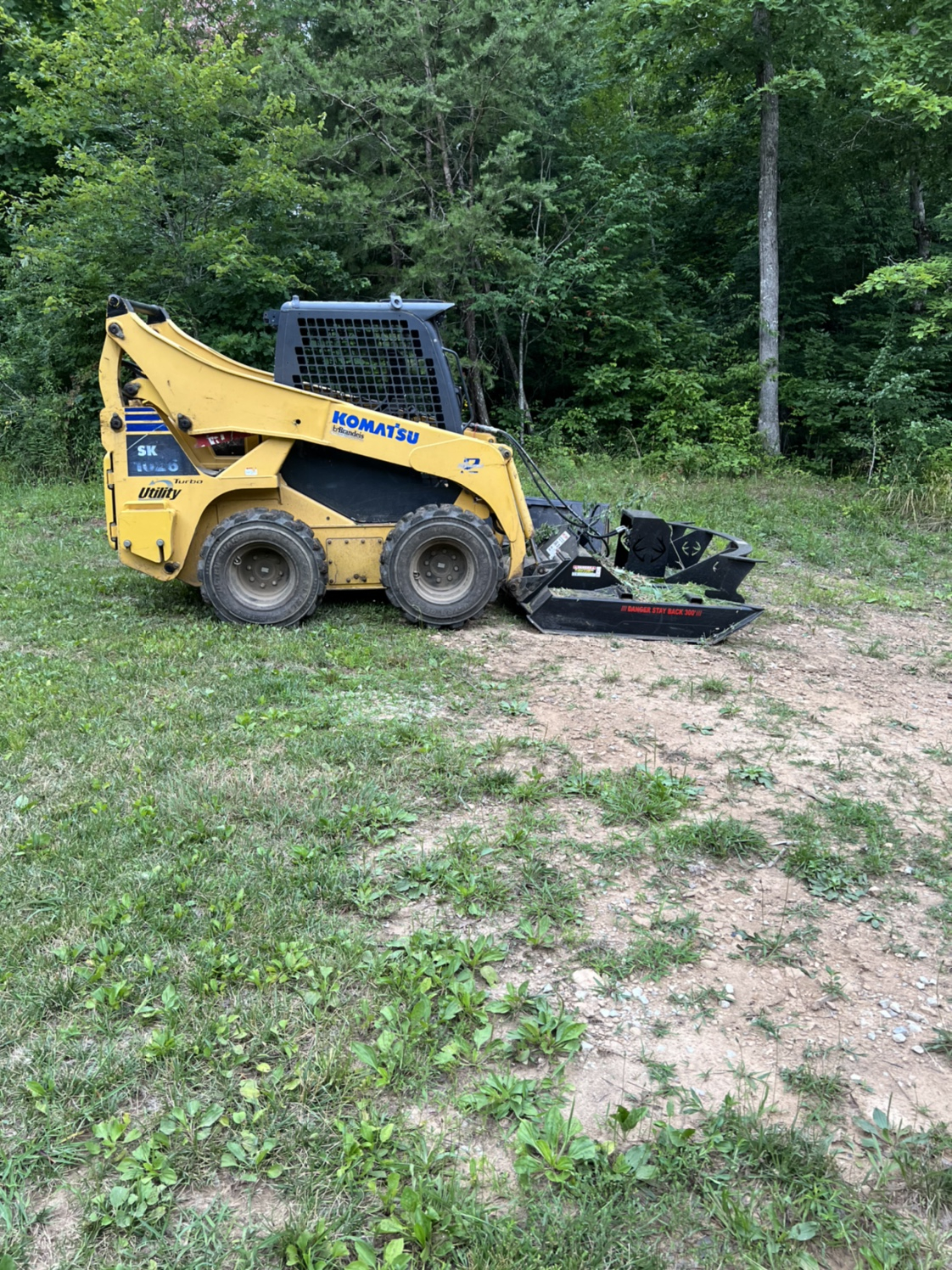

I looked into a mulcher for my KX-040. I’m sure it would beat the heck out of a string trimmer but based on the videos I’ve seen it’s pretty lacking in the hydraulic recovery abilities. I decided to buy a mower for my skid steer instead.
