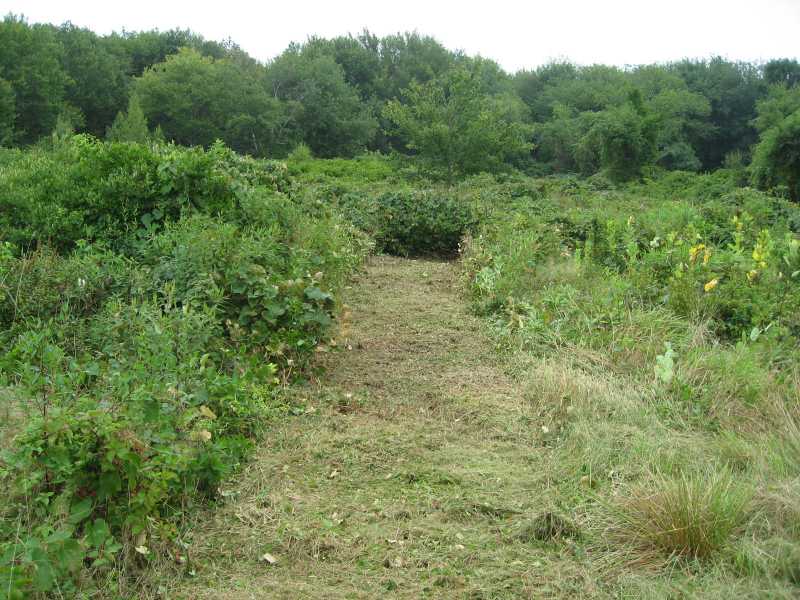

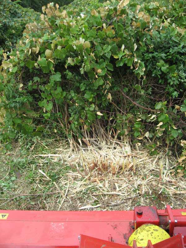

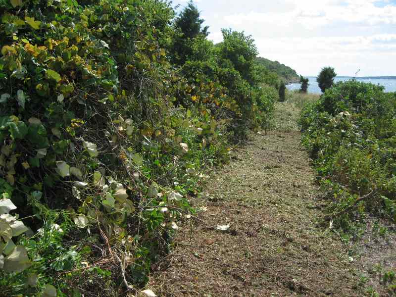

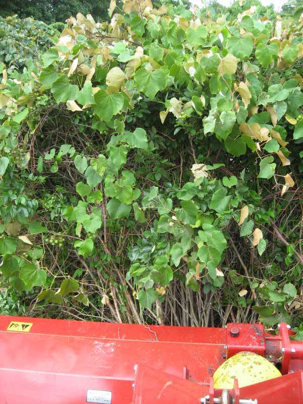

To expand on Art's answer: Just as there are different types of rotary mowers (eg finish and bush hog) there are different types of flails or at least different setups for flail mowers depending on whether you want primariy finish or rough cut. Flails can have knives for finish and light/medium brush or "hammers" for heavy brush.
In general, a typical light/medium duty flail mower overlaps the functions of a finish mower and light/medium duty bush hog. A heavy duty flail overlaps with a heavy duty bush hog. Light/medium duty flails cost about the same or a bit less than finish mowers or medium duty bush hogs. Heavy duty flails cost more than even heavy duty bush hogs.
Flails are generally safer to use around people/buildings/vehicles as they don't tend to shoot chunks of wood or rocks etc out from underneath the way rotary cutters do.
Flails tend to cut finer than the equivalent rotary cutter and are a bit more forgiving when hitting obstacles but because they have 40-60 knives/hammers typically, they can be a lot more work when maintenance is finally needed.
I have used a bush hog, a finish mower and a flail. The bush hog cuts most anything but leaves big chunks of material behind so multiple passes are needed to break up debris. A finish mower obviously cuts very nicely but is damaged by running into brush or rocks etc. The flail cuts material you'd generally use a bush hog for but leaves a finer cut pretty close to that of a finish mower.
Photos of a medium duty flail (Caroni TM1900) ($1600 from AgriSupply).
