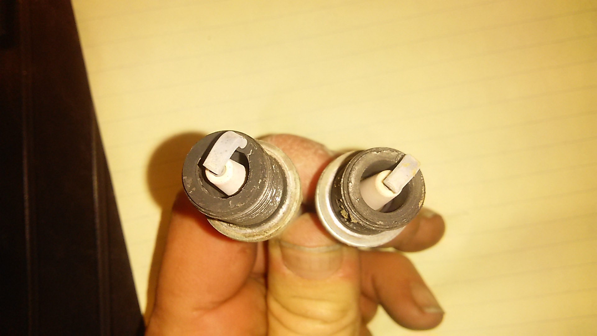

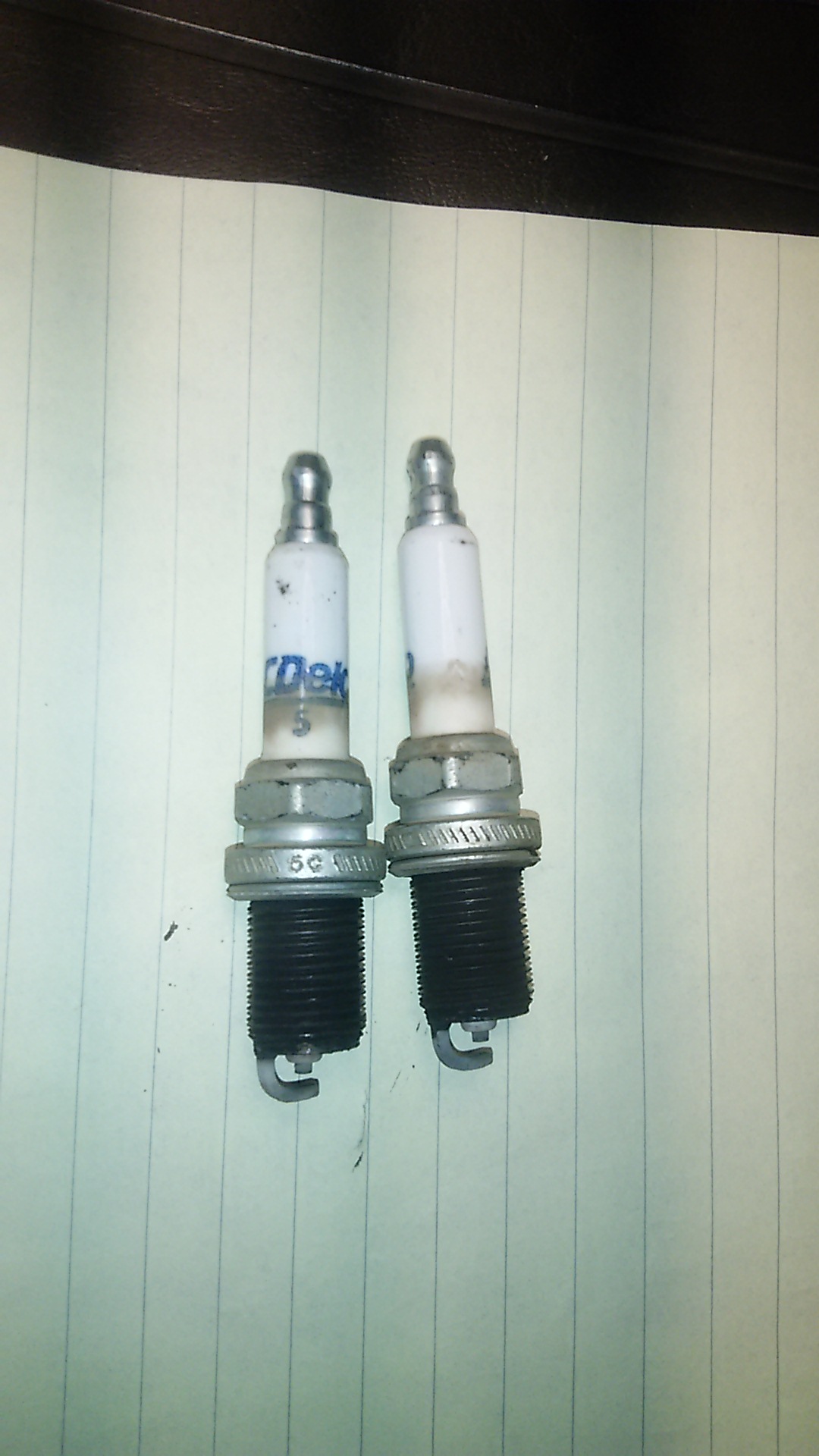

Pull both spark plugs, and check the color. Both slightly black, or is one clean (sign that you have a bad coil)? OW, probably running too lean.

So I'm looking for manifold gaskets, with little luck, but I don't see anything that would indicate a leak. I pulled the fuel shut-off solenoid and touched it to 12v, and it is working fine. I cranked the motor with the fuel line disconnected and was rewarded with strong pulses of fuel - I replaced the fuel line for good measure. I don't suspect I can check the flywheel without pulling the motor though. Here are what my plugs look like - best I can tell they look like the "normal" picture when you google image "how to read a spark plug."
So I really don't have a plan moving forward, except trying to find new exhaust gaskets / studs / nuts. I am questioning if I even have an issue, or if the exhaust glowing at night is normal. I don't really want to find out by hosting a huge fire behind me as I'm pushing snow.

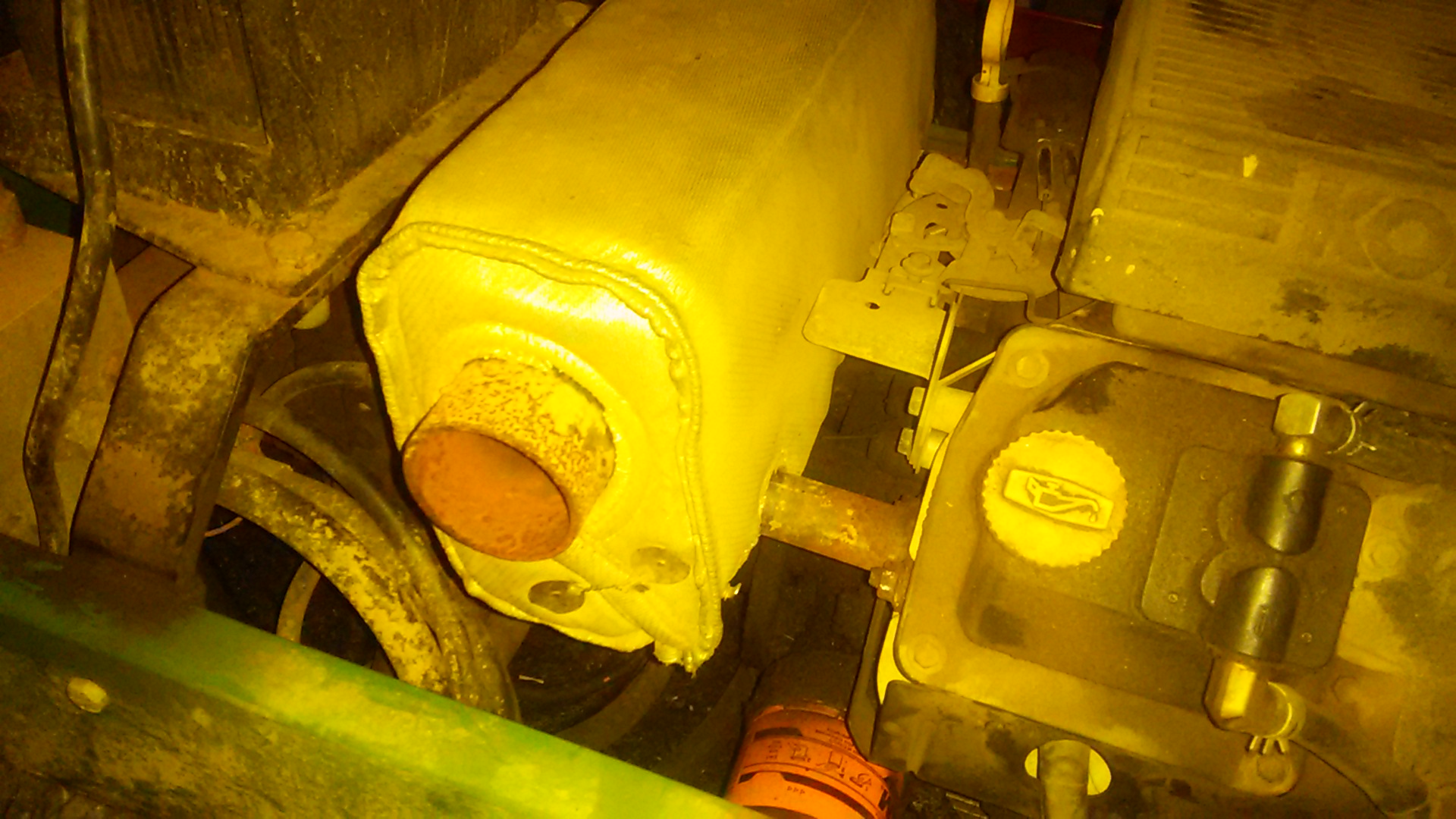

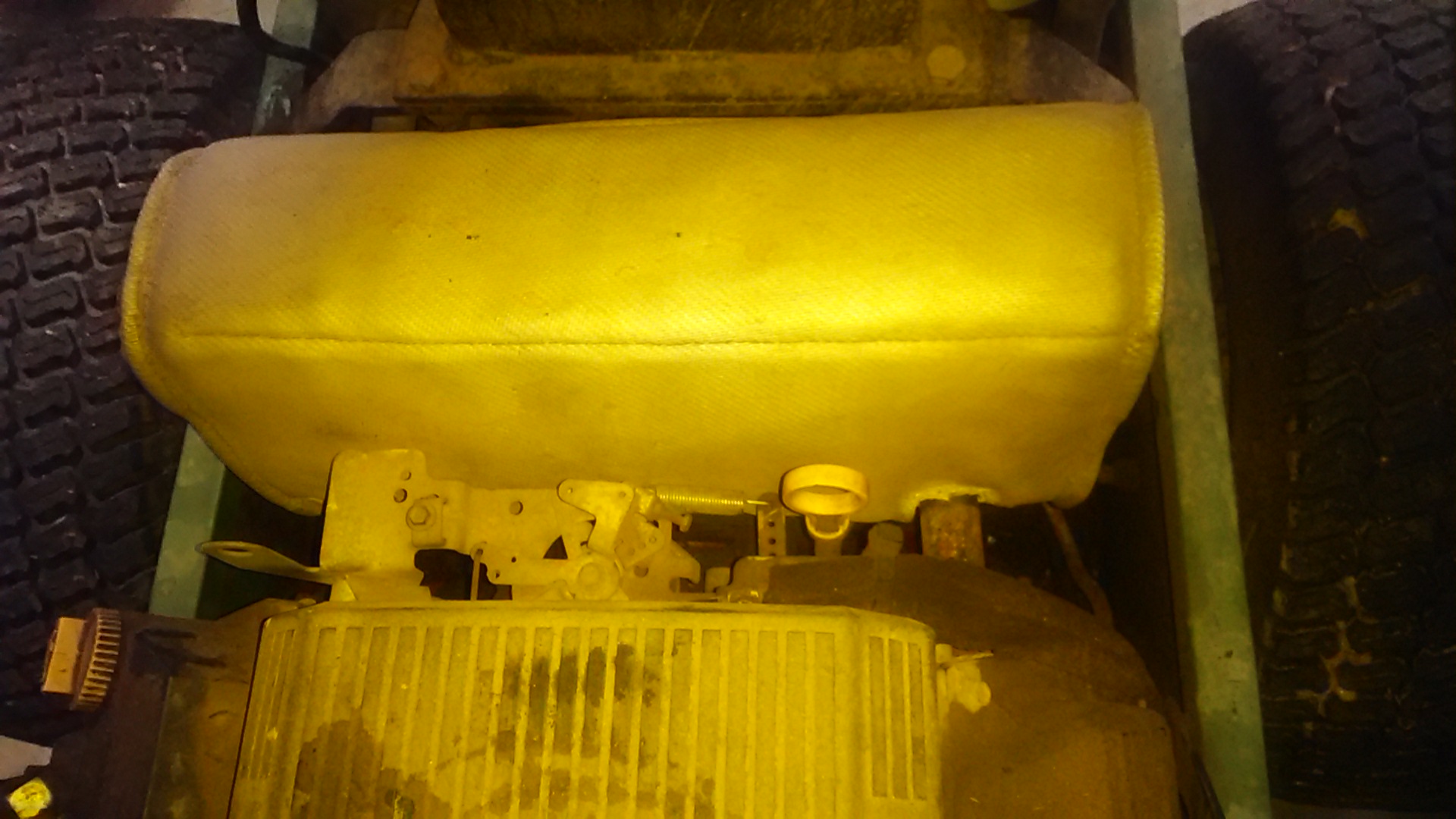

   / Flames out of exhaust
#9
This is the exhaust on it. I assume it's a PT "special," and not original Kohler. When I look through a gap in the silverish heat cover (probably asbestos cloth?) I see the glowing square exhaust and tailpipe. It gets hot enough to warp the expanded metal tub side that it blows through. Maybe that's not a big deal, but I thought I would have noticed it earlier if it were glowing all along
DSC_0499.JPG DSC_0500.JPG.
I've put a couple hundred hours on it this year.
   / Flames out of exhaust #10
View attachment 491030 View attachment 491031.
