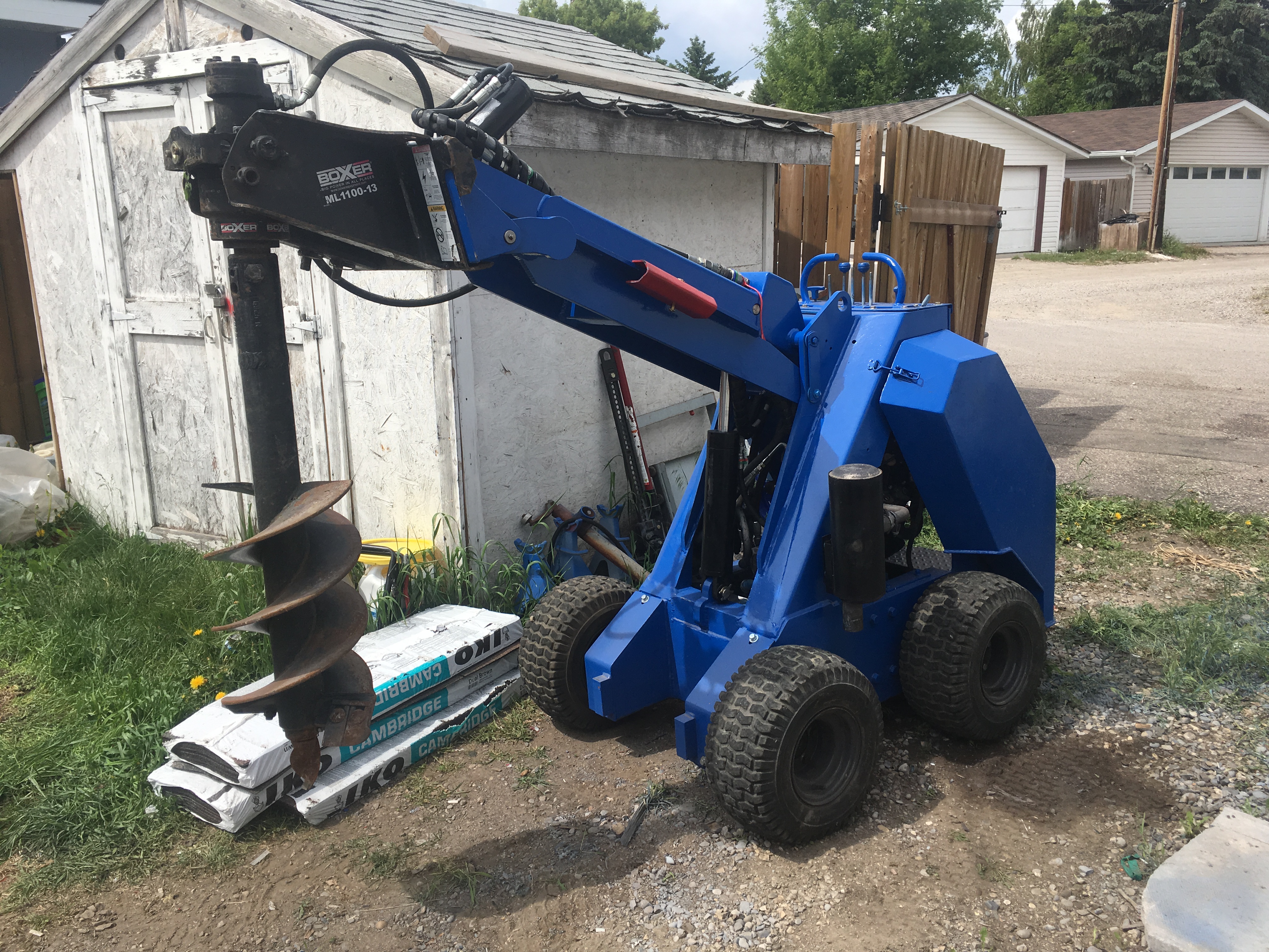

If anything, I 'assume' issue is either running too rich, or exhaust valve failure, , not real experienced with these type of engines, but, thats why I am posting here hoping to get more info than take to a shop which I can't afford to. Been off work for near 2 years and picked up this machine to dig post holes to try an eek out some sort of existence, , , Picture 002.jpgPicture 001.jpg

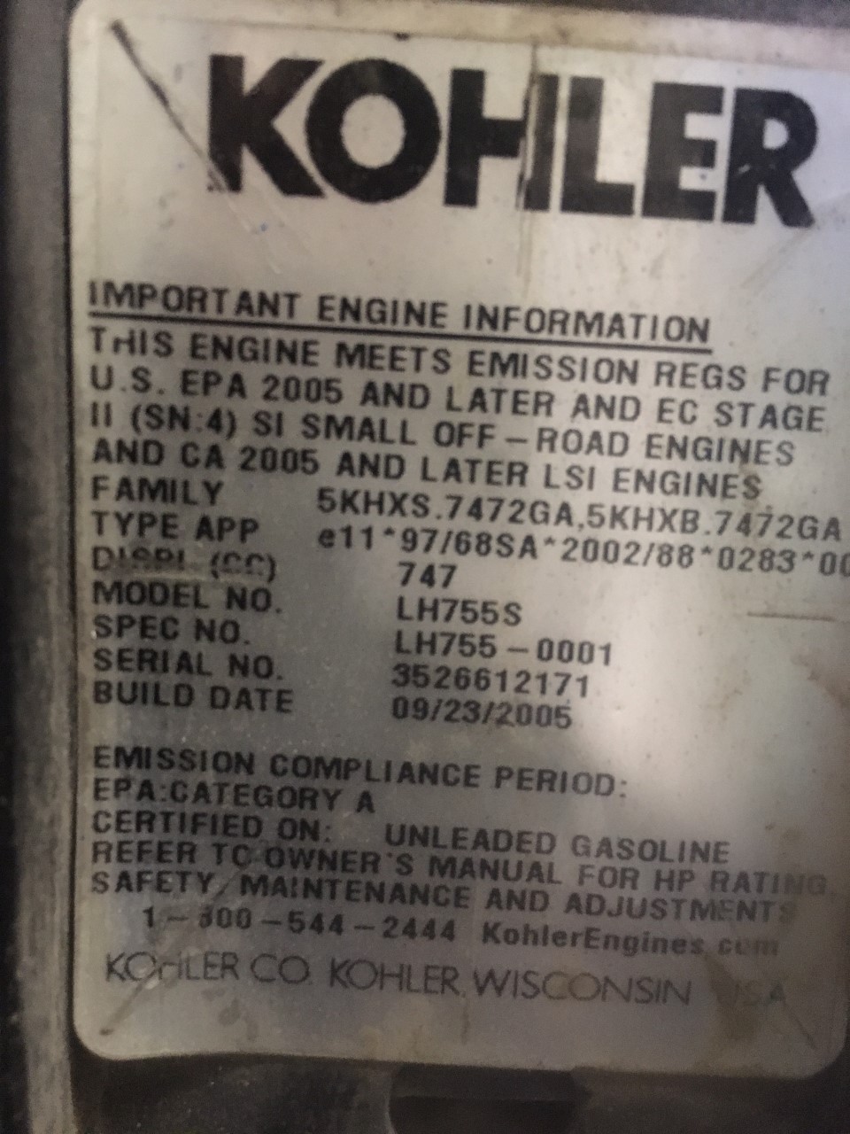

Probably runnin lean. I would check filter and fuel pump. Make sure you have a clean tank and the gas vent cap isn't plugged. If those check rebuild replace the carb. Then onto timing and valves. Crazy machine. What is your engine specifics?

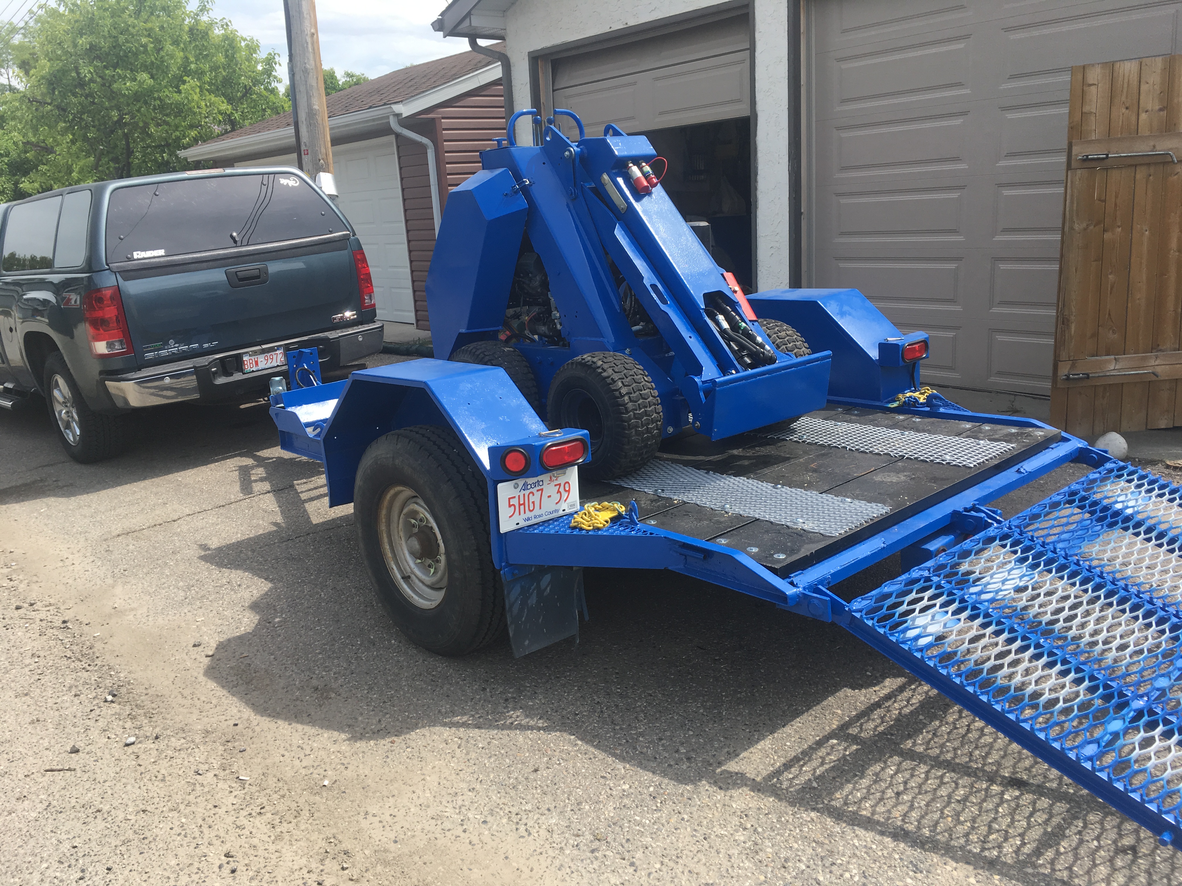

Hi Digger, , ,

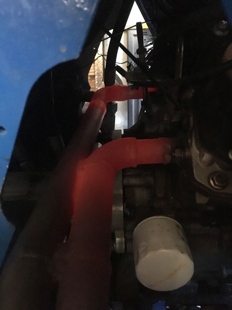

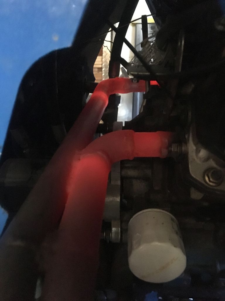

I have a Kohler LH755 mounted on a RAMROD 950,Picture 006r.jpgPicture 001r.jpgPicture 002r.jpgPicture 003r.jpg with serious heat issue, , , ports from cylinders get cherry red, , ,
have replaced / re gapped plugs to .030, did compression test - 140 psi, pulled flywheel to check Woodruff key - pristine, ( cleaned magneto coil and magnets while flywheel off ), check throttle body of carb for movement - ok, ,
I have to ;assume' that exhaust valve is the issue but not sure how to move forward on it, , any ideas are appreciated.Picture 001.jpg

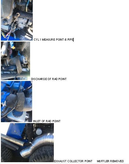

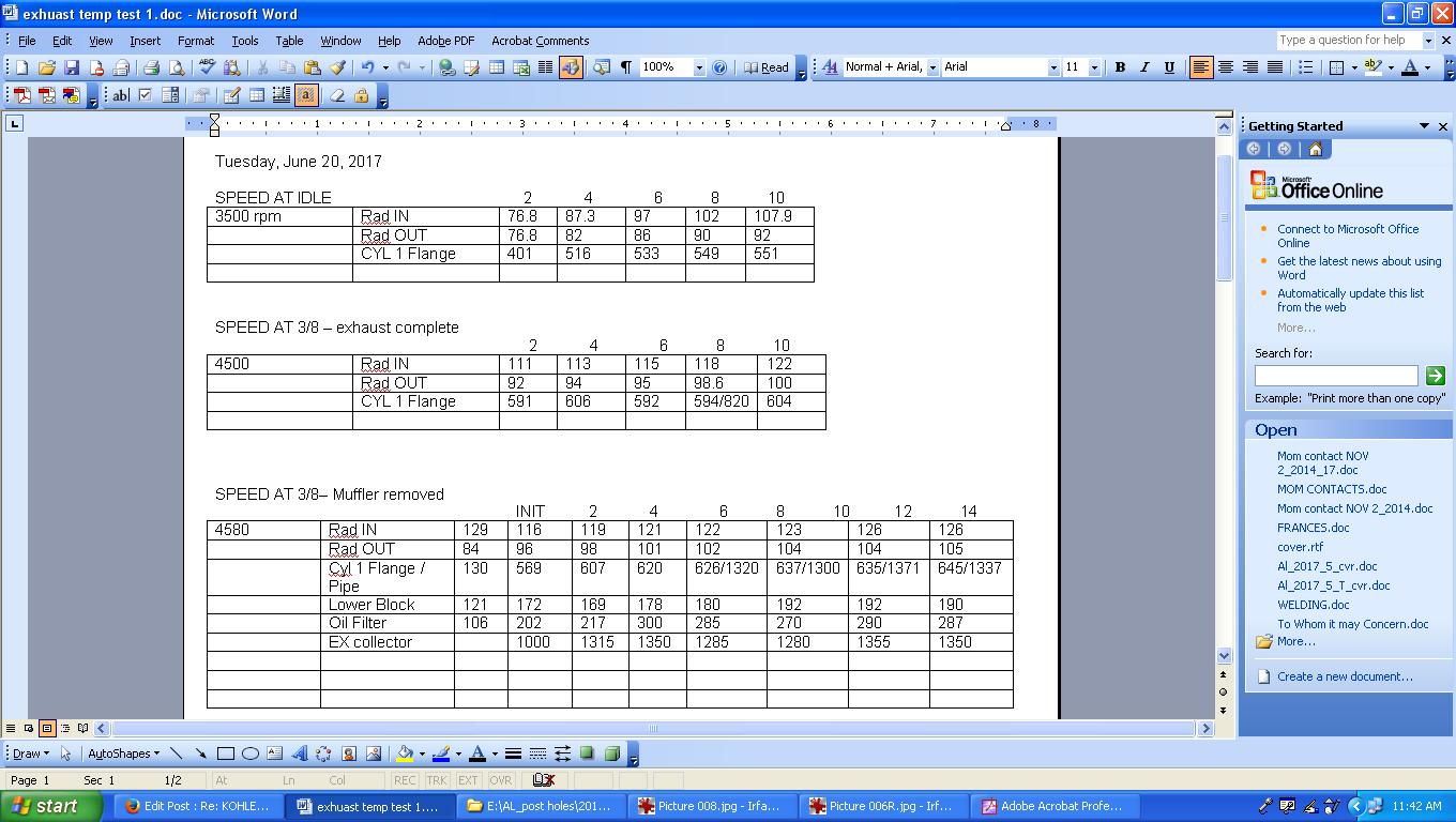

new fuel, fuel line and filter, FM vent cap on tank, pulled flywheel - woodruff key ok, clean magneto and magnets and pick ups, re-set pick ups to 0.30", new plugs - gapped .030"
ran tests as suggested,
1 - idle speed an record temps muffler complete
2- avg running speed muffler complete
3- avg running speed muffler removed
Picture 012.jpgPicture 013.jpgPicture 012.jpgPicture 013.jpgKOHLER ID tag.jpg

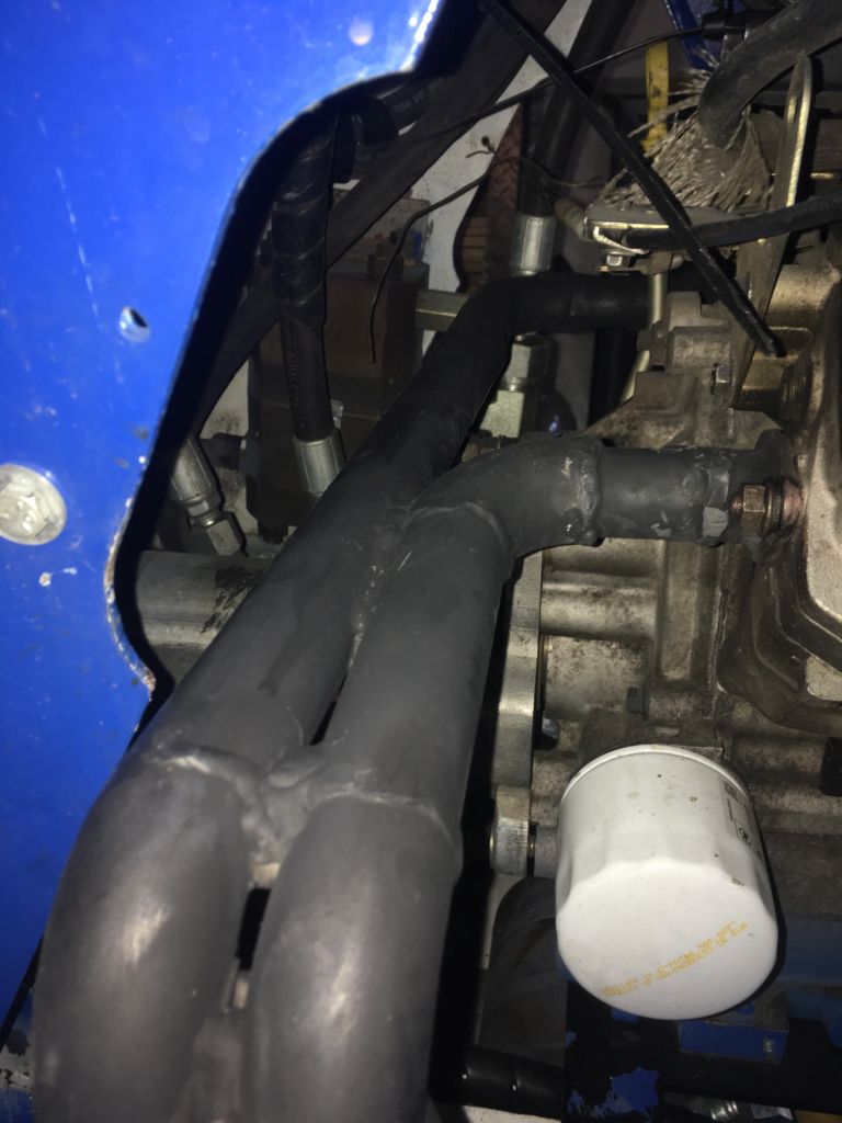

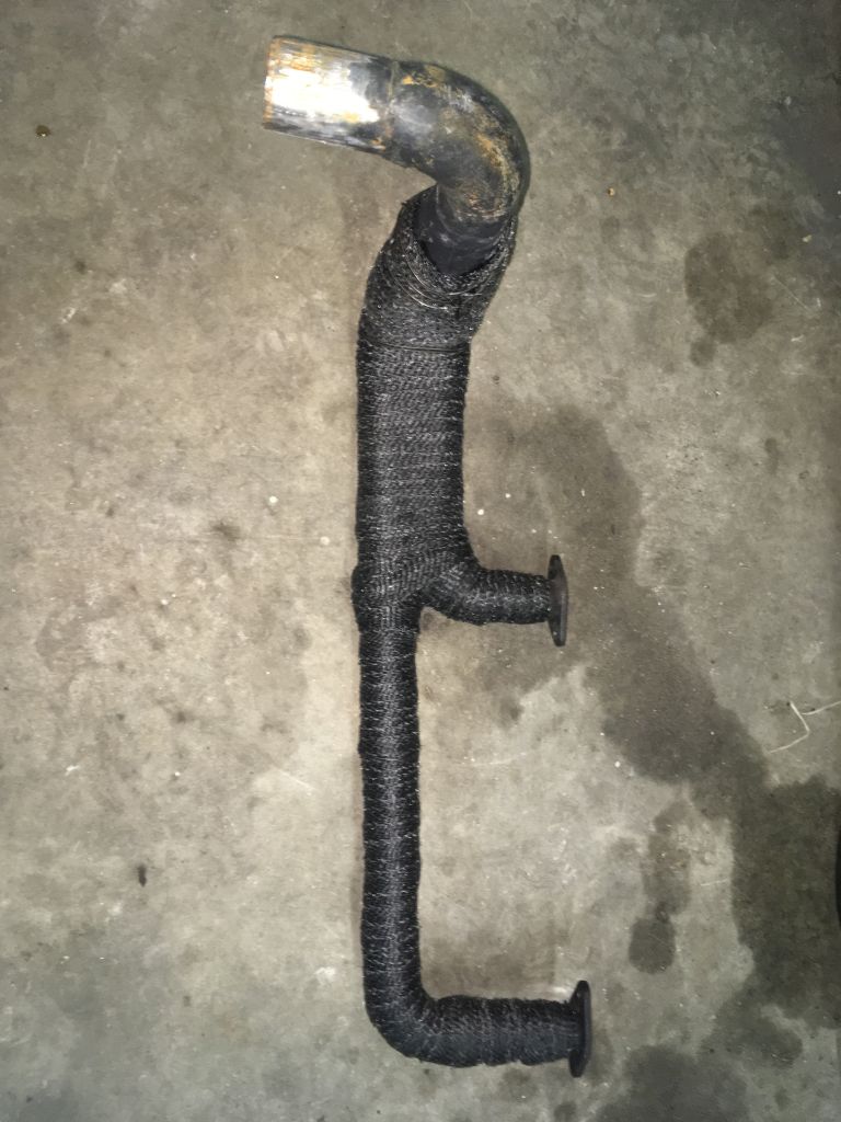

   / Flames out of exhaust #26
well part 4 of this experiance, , ,
was able to get a small engine mechanic over to go thru the unit
1- governor / choke / throttle linkage gummed up, as throttle increased, so did choke come on, , clean all an move independently now
FINALLY got word back from KOHLER, their engines do run hot at exhaust port, , thats why mots of their machine shave exhaust / muffler tight to the engine an real close to the exhaust ports of cylinders, ,

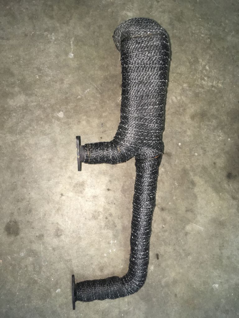

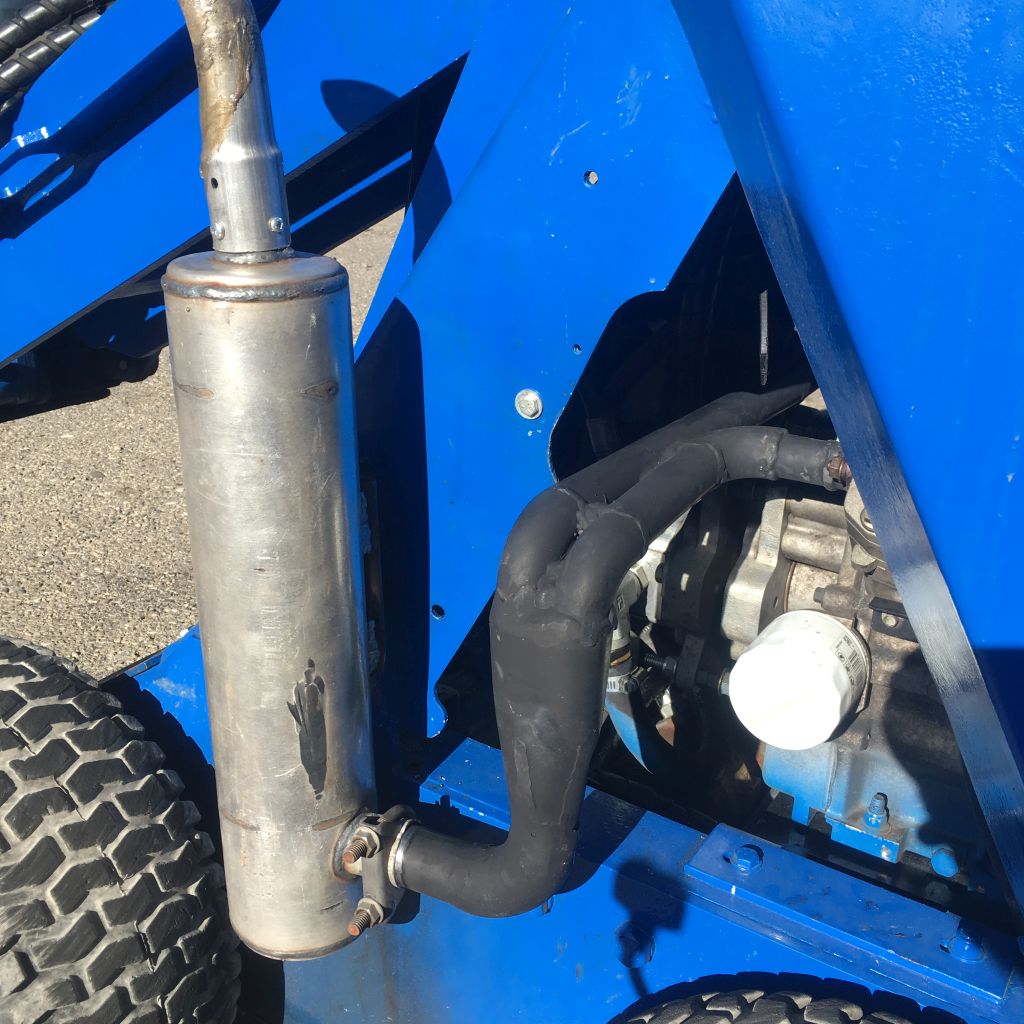

went to MOPAC in calgary an got a few rolls of exhaust / header wrap and got at it, , ,
also, replaced exhaust port gaskets, ,
needless to say, after dropping idle speed to 1100 rpm, wrapping exhaust and including heat shield(s), new gaskets, linkage cleaned an smooth operation, 90% of problems eliminated, , runs smooth, wwaaaayyyy quieter and looks good, , ,
never assume what you bought used is 'good', , check over everything an get a decent knowledgeable person to help diagnose, , going in circles is not the answer, , and most importantly GET THE MANUALS FOR YOUR EQUIPMENT !!!

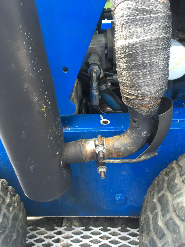

   / Flames out of exhaust #27
Nice!
Watch those tires to be sure they don't get too hot. I wrapped the exhaust too, and put the muffler on the outside, seems like the engine compartment is a little cooler.
   / Flames out of exhaust #28
Temperature at exhaust pipe to muffler is about 250, , added a shield at collector discharge :thumbsup:
