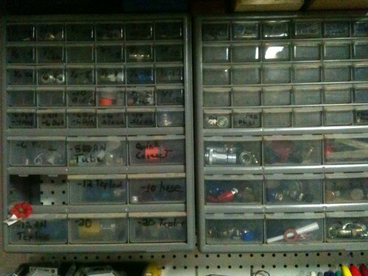

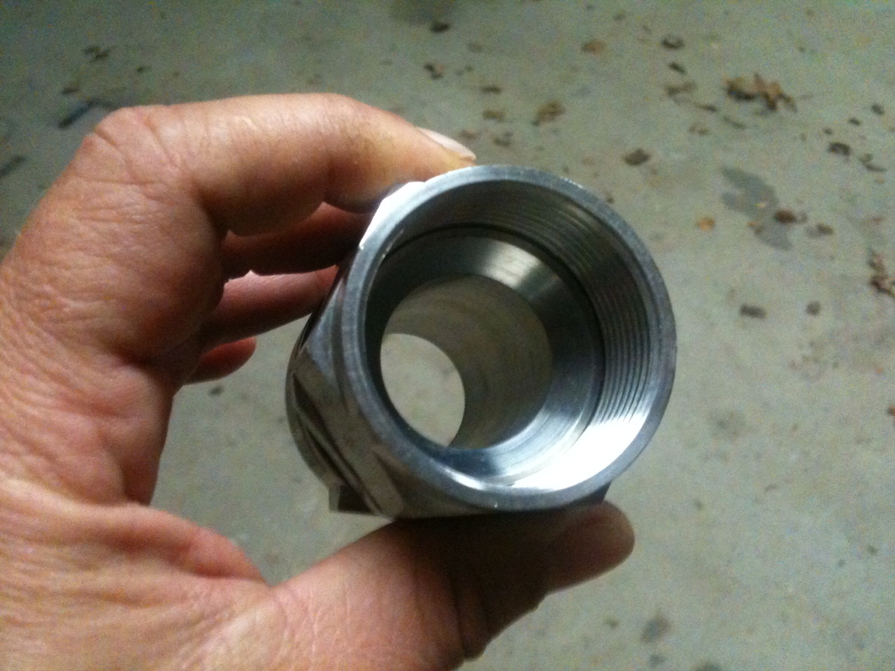

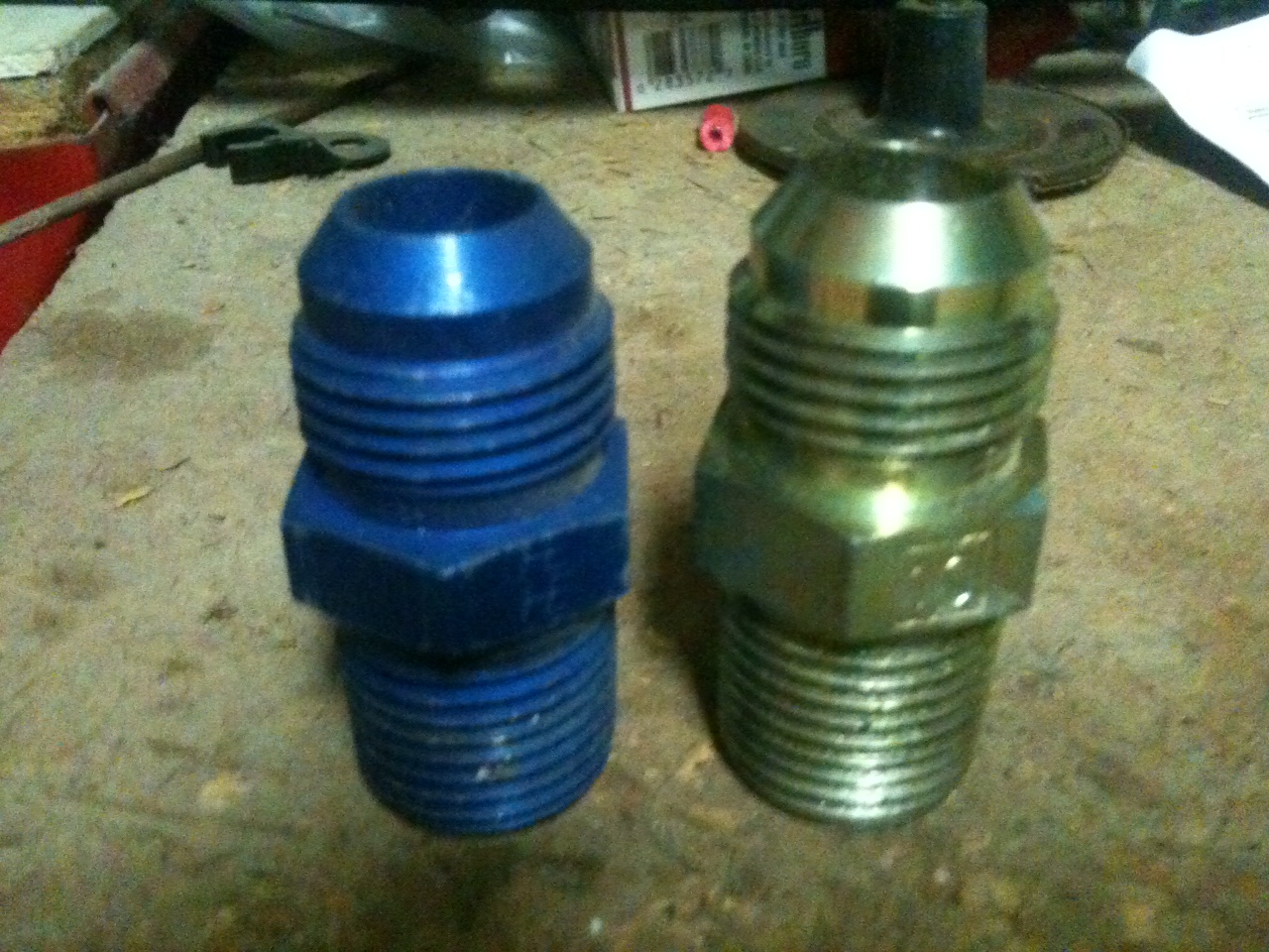

Good info here but want to point out that JIC 37 and AN are completely interchangable unless you are building a commercial Aircraft or working under a contract for the Government that requires the use of AN fittings. For hydraulic or automotive use they are COMPLETELY interchangable. AN fiitings simply conform to a higher materials and thread dimension tolerance. From J_J's link above:
"As a result JIC or SAE 37 degree fittings are perfectly interchangeable with AN fittings, and while this may not be acceptable for military aviation use, for automotive use there is no downside other than perhaps mismatched color coordination as JIC fittings are not available in the pretty anodize aluminum colors. However this may be a worthy tradeoff considering the JIC fittings are a fraction of the price of their true "AN" counterparts"
I do A LOT of work with both JIC and AN fittings and the true AN stuff is expensive. The hose fitting in the picture is a 20AN for teflon hose and cost about $160 each.
The blue and gold fittings are both 1/2" NPTM to -8 AN the blue one is a true AN fitting (~$11) and the gold is a JIC 37 (~$1.50). They will physically, completely interchange!
The middle pic is of my fittings bin. 95% are true AN and the rest JIC, ORB, and even some Dyna Tube.
I didn't read this on the internet, I just took these pics in my shop. - JIC 37 and AN will completely interchange unless your design/contract criteria call for the more stringent standards of the AN. You will find VERY few true AN components in any hydraulic shop, they are insanely expensive compared to their JIC counterparts. The 45 deg stuff IS completely different and WILL NOT interchange safely.
