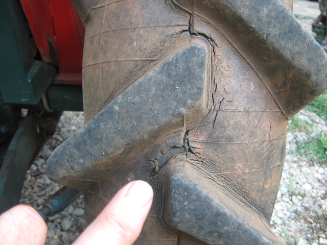

Yes they do fit......:thumbsup:., My son and I mounted them yesterday, However we manage to pinch one of the inner tubes so we patched it, although having to add an extreme amount of air into the tube (50 lbs) in attempt to get the tires bead to seat, apparently the patch didn't hold under that much pressure:cool: ( went flat over night )..... So! now I need to install a new inner tube, back to the tires themselves are certainly more size differences between the old 8.3 and the 9.5's than I thought would be, with being less than 1" left between the tire and the fender, it has set the tractor up approx 2" higher in the rear which was something I wanted to do, Remember a while back when I installed some 15" wheel/tires on the front, doing this added additional 2" height and more clearance to the front I hope all this extra height doesn't make it more susceptible to turn over, though it also seems to have a wider stance with the 9.5 tires,

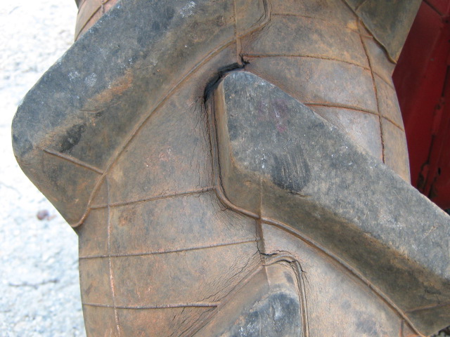

Those look like some good tires you got!! Im sure your old one will round out as well when pumped up to appear taller?
They look good though nice lugs and dont look dryrotted a bit in this pic! Lugs look a good bit taller!

Those look like some good tires you got!! I'm sure your old one will round out as well when pumped up to appear taller?.
No not really, they are what they are, tractor tires don't necessarily get larger when they're inflated, I mean unless were to over inflate them, you can see by the old picture how much more room between the tire and the fender, I have 25 lbs air in the 9.5, and had about 20 lbs. in the ones I took off due to them being so badly cracked, Otherwise would have ran about 25 in them as well,

You realize that these tires per the book (Yanmar service manual i have) are suppose to be run with 14lbs of air in them right? Not saying that im right on the tire issue, i beleive you, im just saying that due to your cracks, you might not be albe to see them at correct PSI.

No I didn't know the correct air pressure should only be 14 lbs/-psi, I've always run what look to be normal for the tires dry rotted condition, if the tire pressure were too low the sidewall cracks would open and if had too much air in them the tread cracks would start to open, so right around 20 lbs provides an intermediate pressure for both conditions of the tire, ( on a side note:) It's too bad one has to inflate these tires to almost 50 psi in order to get the bead to seat, because what started out to appear to be a good none rotted tire now has some places in it that are in fact cracked,:irked: I think having run inner tubes must make the tire more difficult to seat, because the tube is pushing against the tire rather then only air pressure alone, The inner tube has to reach a certain inflation ( 50 psi ) causing the tire to over inflate to seat, even after using soap to help, and this isn't in just one try, it took 3 attempts,after it finally seated I then lower it back down to 22-25 psi,.... Though! now that I know the specs I'll try to run even less air pressure,
