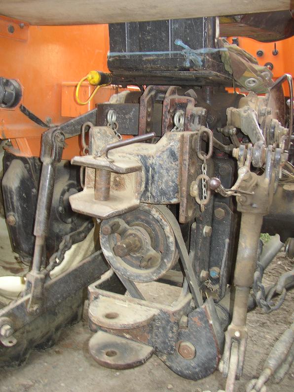

Bird,
Just curious question. Why do you use trailer hitches on 3 pt?
What kind of coupling systems on tractors do you use in US?
Ball hitches we use only for personal car trailors.
Tractor here have hitches over and below PTO shaft.
Single and tandem axle trailors can be coupled on both ways (depending on trailor version), when 2 axle wagons use hitch over PTO shaft.

I concern that this is DANGEROUS WAY, not only because of rising up of trailer tongue, then because of lifting up tractors front end. This was main reason of my curiosity.
We pull trailers here as close as possible to rear axle. OK, you can't turn extremely sharp, but it is safer.
Yes, I know for automatic single (or tandem) axle trailer couplings. But they are using hydraulic lift just for opening/closing (lowering/lifting) trailing hook, and when they are closed mechanical system (hook with spring) hold it closed. Haven’t these pictures yet.
