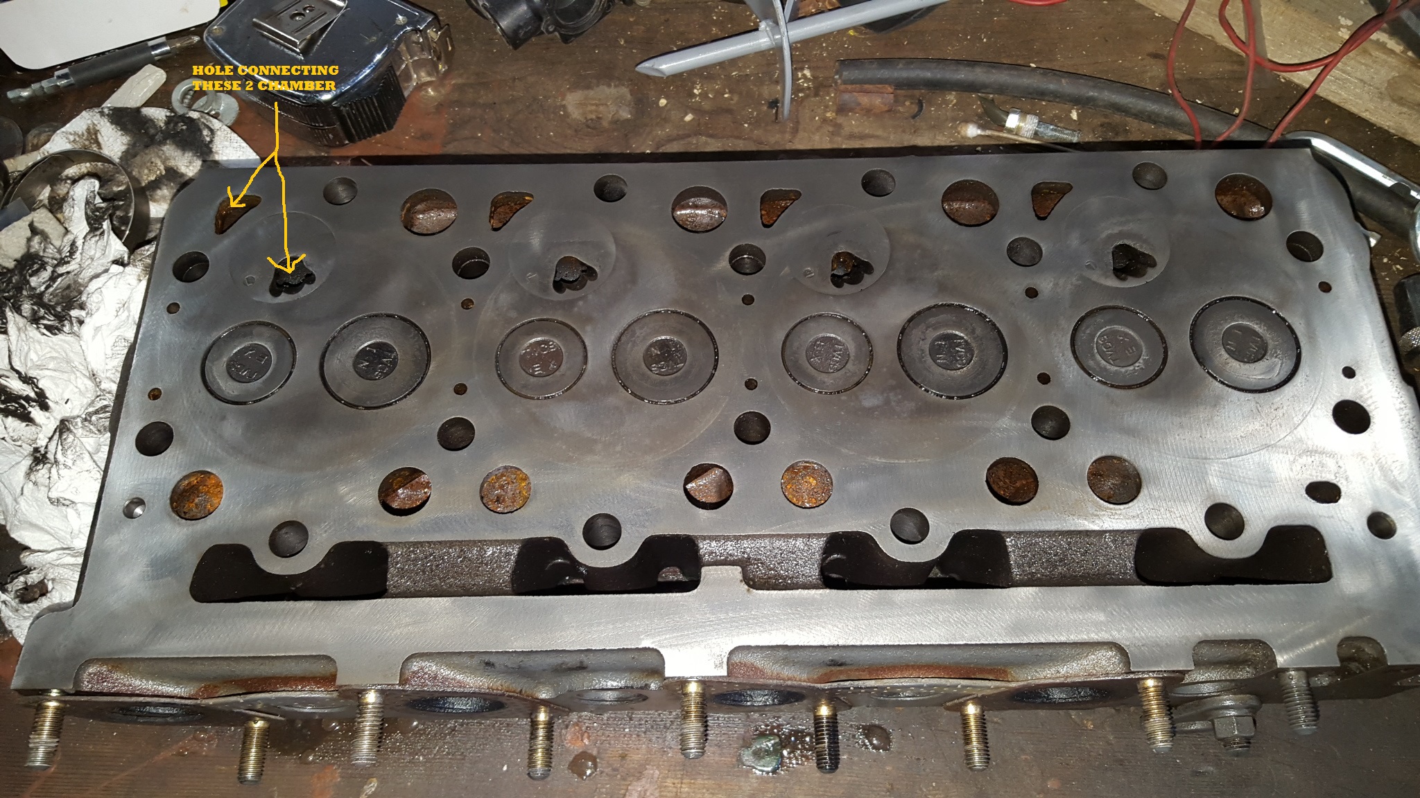

Did compression test, and as i thought. Good compression all cylinders except last one. Pulled intake manifold and made sure cylinder was top center so valves were closed and poured some more water into radiator. Water came out last glow plug hole and no where else. So i drained and pulled head again and found the hole. It his deep inside the air mixture chamber between the water water chamber and air chamber. Highly doubt any body can get in there to weld it, so it is looking like a new head. HEAD.jpg

I admire your disipline in finding the problem.
Have you come up with a plan?
Look for a used head/engine?
Buy a bare bones casting or try to source a complete head?
Some Kubota engines are used in stationary applications and may have another source.
   / Flipped my L48 Kubota #56
...... found the hole. It his deep inside the air mixture chamber between the water water chamber and air chamber. Highly doubt any body can get in there to weld it, so it is looking like a new head.
Kumar bros. has new bare head (with guides and seats) for $474 shipped P/N 1g851-03040, 42. We've had good luck with their parts.

Did compression test, and as i thought. Good compression all cylinders except last one. Pulled intake manifold and made sure cylinder was top center so valves were closed and poured some more water into radiator. Water came out last glow plug hole and no where else. So i drained and pulled head again and found the hole. It his deep inside the air mixture chamber between the water water chamber and air chamber. Highly doubt any body can get in there to weld it, so it is looking like a new head. View attachment 456157
Agree it's time for the new head. I missed it (somewhere in this thread probably) but how on earth does flipping a machine over result in a new water path internal to the head on the engine !!?? I don't understand the mode of failure.
   / Flipped my L48 Kubota #59
The original post described a severe over-revving event with likely destructive combustion pressures and mechanical overload. The engine was stopped before multiple failures happened. But at one spot in the head combustion pressure broke an internal web to a water passage. The tough thing is that there could be other parts that got over-stressed and may not hold up after this. No real way to tell without putting it back together and running it.
