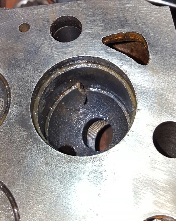

So I put the new head in. Getting a clanking noise, and possible miss fire. Hoping it is just a bad injector that may have gotten wrecked in that hydra-locked cylinder. If i do have to break then engine down, i guess it will be a good time to fix my hydraulic fluid leak from my main seal in the transmission. Been putting it off because you have to break the tractor in have to do it. I pulled the insert out on the head exposing the injector chamber and you can see the failure. 20160206_150911-1.jpg

Clanking noise in upper end, or dull clanking from lower end. I wonder if you possibly cracked a piston with the hydro locking. Hydro locking is rough on everything.

I'd really look at that lower end post haste. Might have beat a rod bearing out or 100 other bad things. None of them get better by themselves, they get more expensive when ignored. I'd stop and see if I still had a viable crank... :(
