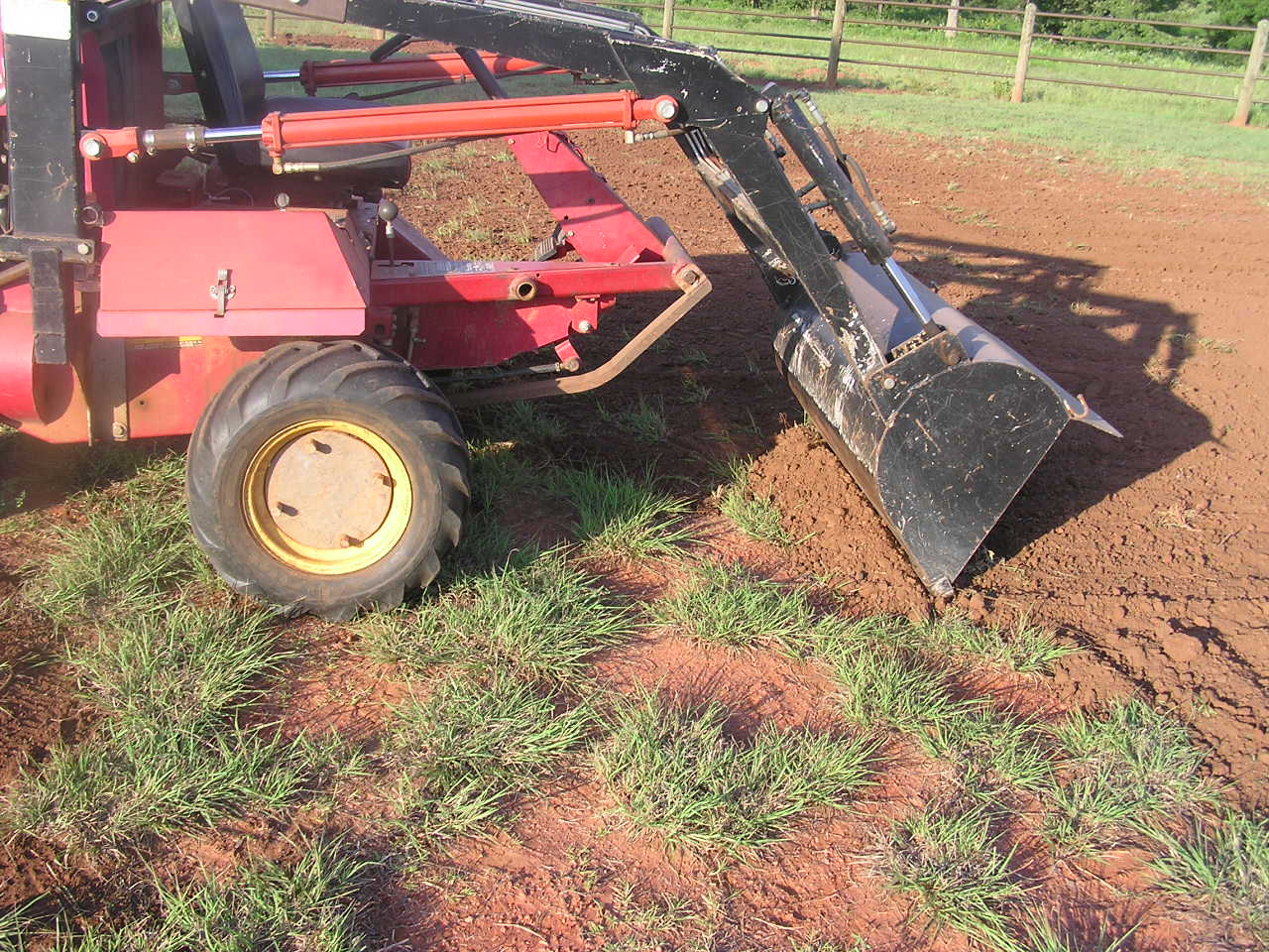

The float position has many uses depending on the implement you have on your FEL. In my case, I frequently use it to level uneven ground by making multiple back dragging passes with the bucket. It also works well for spreading certain types of material. I usually back drag in float when clearing snow from in front of my garage doors or other areas where pushing isn't practical.

I to use float fairly often when leveling just spread gravel or dirt to get it level. If I want to be a bit more aggressive then I tilt bucket so front edge of bucket is all that is on the ground and not the bottom of the bucket and back up in either float or not under float adjusting down pressure as I go. I sometimes use float going forward but not as often as in reverse.
Using float is like using a boxblade and some other implements. The more you use it and the more experienced you get using it makes it more usable/valuable. Tilting the bucket while using float is a big asset sometimes.

I used my float very successfully to back drag my skid roads after snow falls so that it freezes compacted and makes it more passable for both my tractor and a Yamaha Rhino.

Back dragging is my main use for the Float Position:

Float in 'back drag' depending on bucket angle is an excellent tool/technique.
Loaded bucket and mild tilt angle is a decent compaction trick.
Very aggressive angle scrapes clean and even in negative angle can pull back lose material like sand or fines.
And if tooth bar equipped becomes a great root rake.
