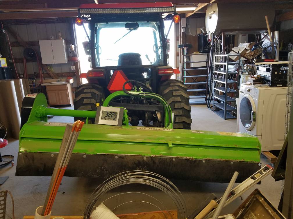

One of the things I was thinking about with the tilt (somehow) floating is with really uneven ground side-to-side with a wide flail (don't have a flail yet as I'm still trying to evaluate how effective I can be with it).

I use toplink float 99% of the time when mowing. 3pt height sets the mow height & float let's the roller stay properly on the ground. Used the same strategy for a rotary cutter before moving to a flail.
I wouldn't grade without TnT, but rarely use float for grading. Mostly with the 3pt up on a finishing pass to smooth out any ridges or tracks.
Kubota rear remote valves suck bad with lots of internal leakdown. I may get a DPOV setup for my side link at some point. That will break float, but stop my impliments from dropping badly in an hour.
I do use float on both when unhitching with the QH. But I just dont use side float as much as i expected. I use top float a lot though as I mostly mow.
I dont find need or value for side float on mine. Just pain from a leaky valve making it sag badly in under an hour. Sucky for roading if you dont pay attention. 87" working width Peruzzo Super Bull.
