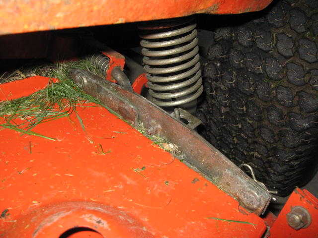

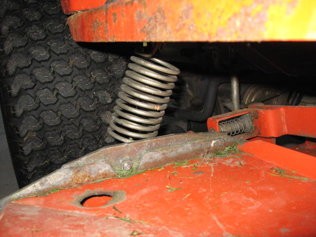

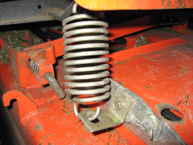

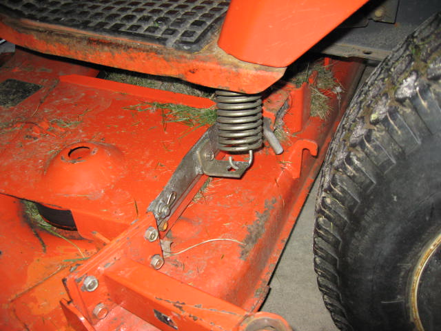

This thread has gone cold since jas67 and I used pm, so I've decided to add some pictures to show the tbn world what we were talking about.

Funkydaddy59 -- thanks for posting the pictures -- they're much easier to see than the poor drawings in the info sheet.
The part # for the spring kit doesn't seem to be a valid part # anymore, but here is the list of parts required (also supplied by Funkydaddy59 -- that's what I like about TBN -- lots of great, helpful people!). I order these on Friday, and am anxious to get it all installed, and stop marking up my lawn (SWMBO will be happy too -- happy wife = happy life :D ).
Description Code No. Required
LOWER STAY RIGHT 66111-88520 1
UPPER STAY RIGHT 66111-88510 1
LOWER STAY LEFT 66111-88540 1
UPPER STAY LEFT 66111-88530 1
LOWER SUPPORT 66111-88620 2
SPRING 66111-88570 2
UPPER SUPPORT 66111-88610 2
SNAP PIN 05516-51000 4
BOLT(M8) 01123-50820 2
PLAIN WASHER 04011-50100 4
SPRING WASHER 04512-50080 4
NUT(M8) 02114-50080 4
INSTRUCTION MANUAL 66111-88590 1
The manual is NLA, but if anyone needs it, just ask.
