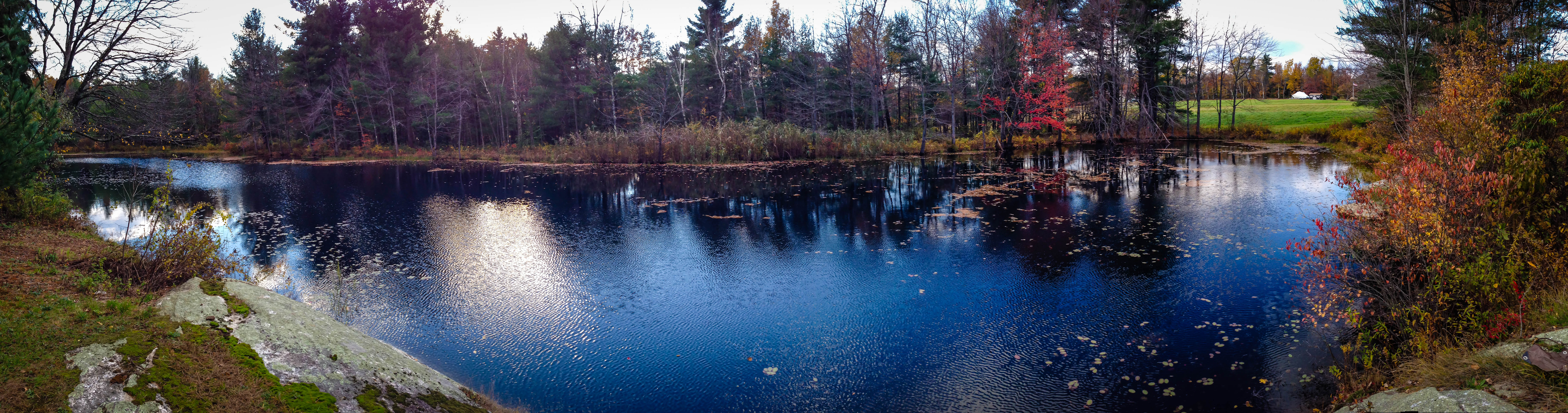

Very nice! My mallard and pekin ducks want nothing to do with my 2 acre pond. They think it is the pond of death! But I have wild wood ducks, mallards and canadian geese that stop by on a regular basis in spring, summer and fall. I've been planning on building a large island and your floating house gives some good ideas.
