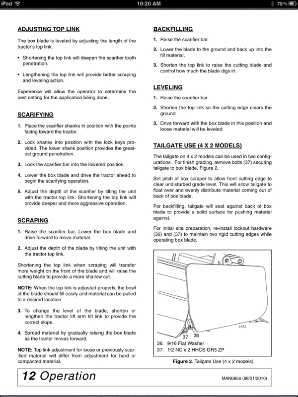

A couple things you all may want to consider are a place to store the pins when the tailgate is not locked in. For the locking tailgate you may want have the pins in location so they will not be pulled out by brush.
   / Floating Tailgate on an ETA Box Blade!! First Look!! #25
That's a good idea, Roger. I keep the pins for my Gannon in the toolbox of my tractor when the tailgate isn't locked, but it would be handy to have a keeper for them on the BB itself (especially for people who share the BB among more than one tractor).

I got the Gannon 4x2 HD. It uses bolts and can be used in 2 configs.

That's why I suggested a hinged plate latch. No loose parts to misplace or lose.
