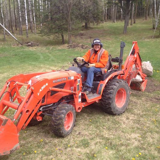

I have a 2013 Kubota B2620 and about 5 acres of land. I bought the mid mount mower, which is easy to attach/remove and cuts great. However, the tractor is too tall for around trees, two heavy for a soggy lawn, and the mower too delicate to drive over rocks (which heave up during the Minnesota-winter). Last fall I used the mid-mount as a trade for a Z-turn and a tow-behind rotary mower. The is light enough to not damage the acre of "pretty" lawn around the house; is low and agile enough to get around all of the trees; and is fast and fun. The rotary cutter is for the 4 "rough" acres out back. I don't need a manicured look and it doesn't throw me (or the blade) as it slides over rocks. It's probably over-kill, but I am looking at the ease of use and safety. (I also have a Kubota RTV 900. I keep digging the rocks up with the backhoe, use the FEL to load the RTV bed up with dirt/gravel mix, and then dump over the holes. I am fighting to have a level meadow - but so far, the rocks are winning!)
