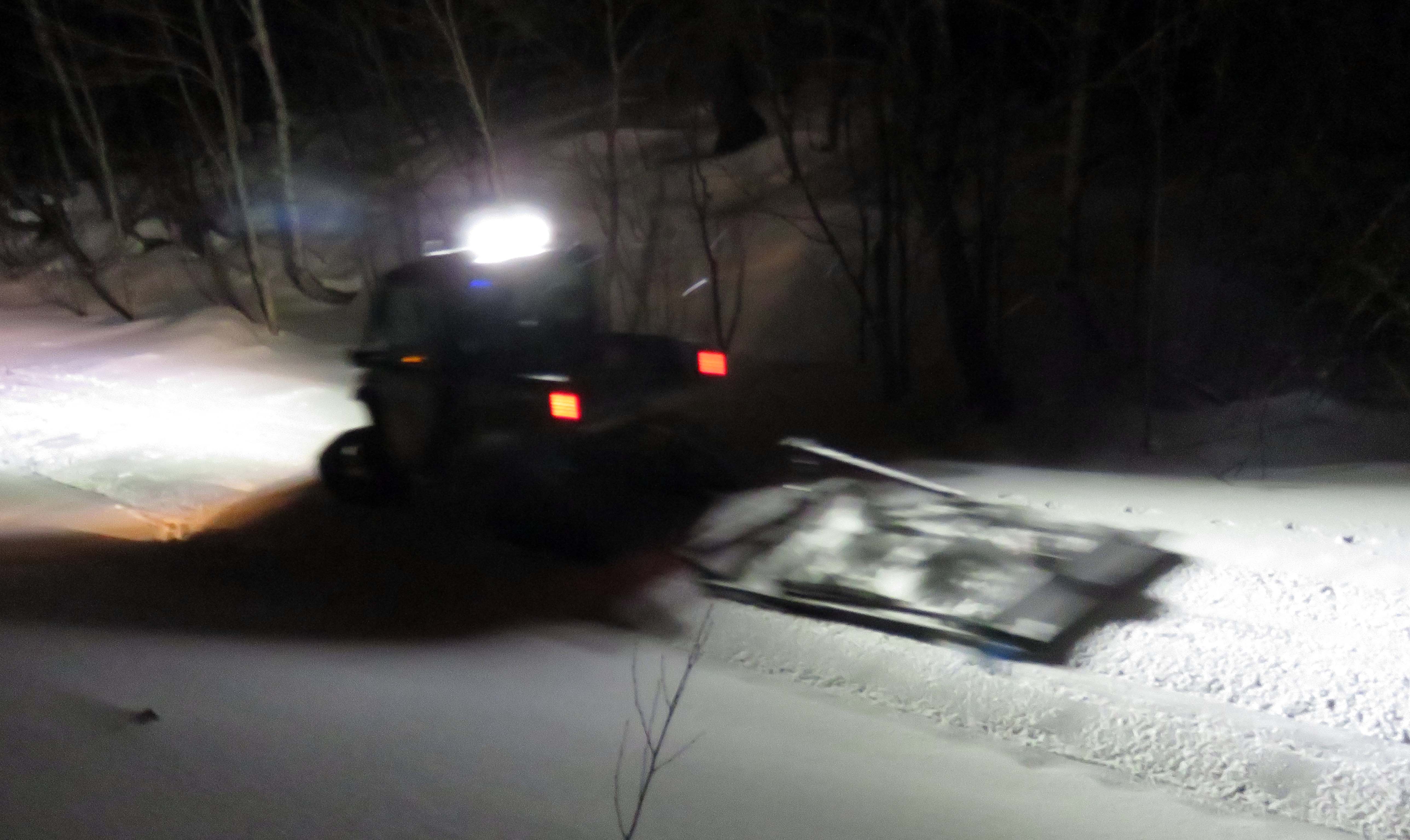

We work at night all the time via utv and atv. We find stock headlamps to be fairly worthless so we add LEDs lights to them. These are mounted higher than the head lamps and aren't very costly either. Nonetheless these 2 LEDs are so much brighter, they'll wash out whatever the headlamps put out. I'll attach a photo of them in action.
Here are the inexpensive lights we run.
Amazon.com: Bear Claw TM BC-27w-CW White Bear Claw Round Work Spot Pencil Beam Lamp: Automotive
