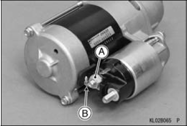

I finally got it running. I took the control panel off today and there was a lot of dirt up inside that cavity so I cleaned it all out then took each harness off its plug and sprayed electronics cleaner on both sides. Put it all back together and tried it. Nothing. So I got back down at the starter and put my meter (reading voltage) across the negative on the starter and across the back terminal on the solenoid.
(meter attached to "A" Z920 Starter&Solenoid.png and negative battery lead at top of starter.)
There was no voltage as I expected but when I hit the key, it turned over and started. It's running fine now.
So my question is, what did I do? I must've completed some circuit or something that jogged voltage to the solenoid so that it would crank.
Thanks guys...
Mike
