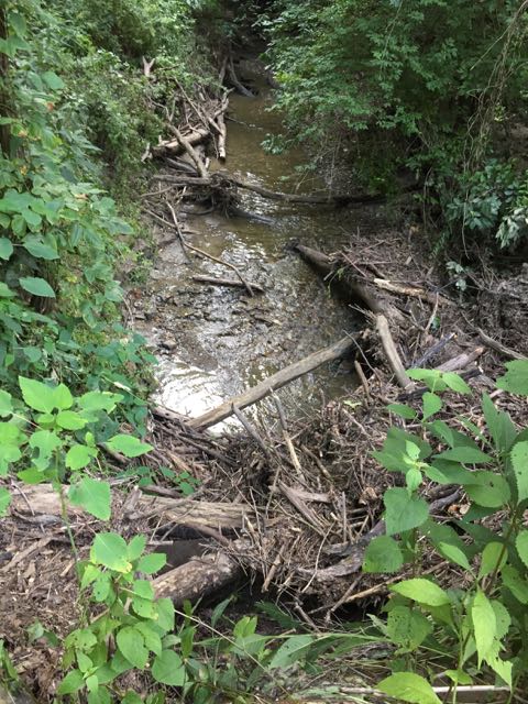

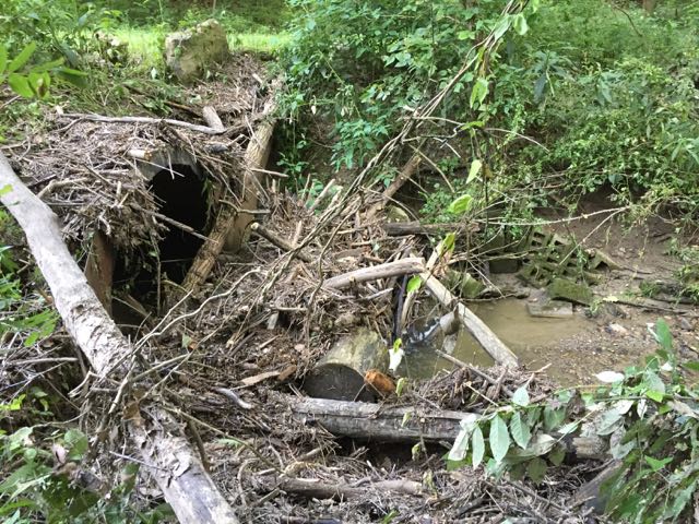

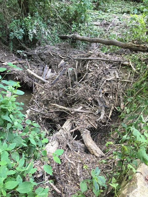

-As for "less than 54 inch lengths"... good thought, and I'll do that, but in the next deluge there will be more stuff than what I cut and clear headed downstream so I'd doubt that it would clear their culvert. The stream is a foot deep and gentle normally so stuff will lay in my culvert till next storm. It drains 3-4 square miles of farm land that is tiled. So when it gets up it gets up it gets up fast and angry enough for my eight foot culvert not to be able to handle. Ha. And I thought I overbuilt for a 50-100 year storm. Not. It overtopped twice in past 2 years.
-The material came from upstream. The stream runs through standing timber. We had quite a rain, so a couple years worth of fallen/dead trees floated downstream.

Get a hook, the type with the 3 Barb's like a fishing lures, attached to a cable and tractor. Just throw into the mess and pull out. I have cleared miles of ditch like this.
Probably one of these designs would work:
Grappling hooks
Bruce

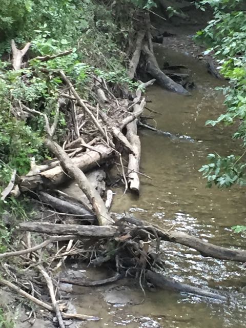

Howdy, have not posted in a long time but thought this would be the perfect place to toss this questions out...
Big rains + emerald ash borer = my 8 foot culvert is jammed with tree trunks and branches galore. If I cut and clear it and float the material through my culvert I would send all the wood downstream (eventually) to my neighbor who has a pair 54 inch culverts. I have no practical way of lifting the logs 15 feet up to where I could deal with the debris with my tractor at my culvert. My neighbor is well to do and has equipment galore and a hired caretaker etc.
So here is the question... as a good neighbor should I let them know that if I cut this material, it is (eventually) coming their way? Should I offer them the chance to remove the crap from my culvert thus helping us both? Am I ethically in the wrong to send a jam down to my neighbor? (Before I put in my culvert all of that would have ended up at theirs anyway)

Absolutely start with talking to them. Plenty of time to lawyer up later if things go south. At least for this particular jam the solution seems to be to cut to lengths that will clear both your culvert and theirs. As a good neighbor they should offer to help with the work since it will help both of you.
Then you can also talk about long term what to do when the jam is such that cutting into 54" length to clear both is not practicable for you.

Talk to your neighbor, explain what you are about to do, see if he can help. I like Snobdds idea of using a grappling hook. Get the hook and get going. You certainly do not want to be caught in your current state - should there be another storm. You could easily loose the culvert AND the driveway.
