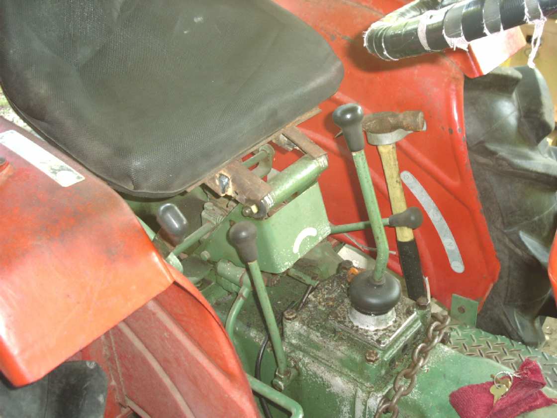

hi Neat 1500,
I removed the 4 bolts, turned it around 180 degrees and bolted it back tight.
No problems for me that way and yes it is much easier to mount and dismount the tractor now. see attached pix. Also notice I moved the seat back a few inches.

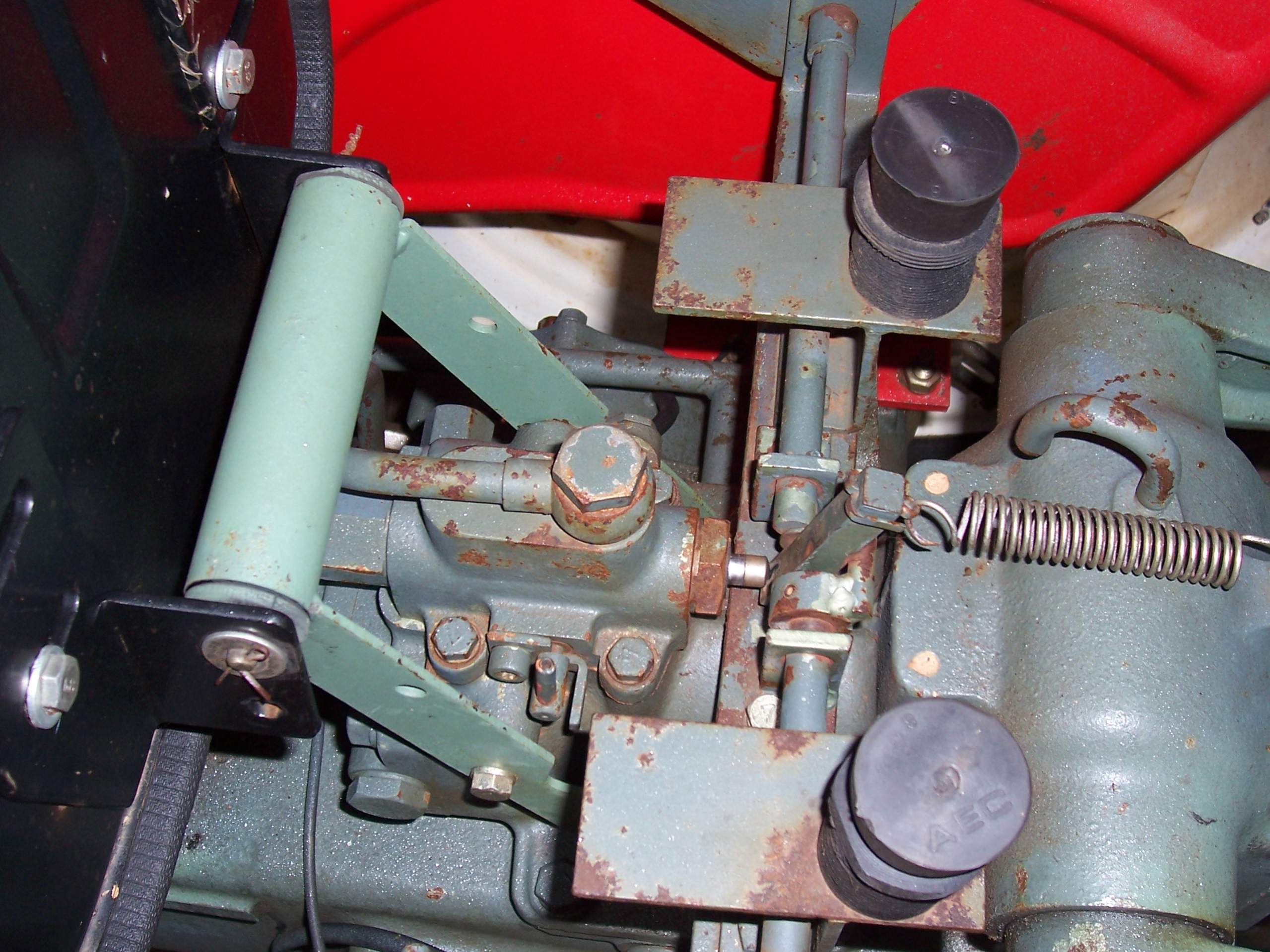

I'll Agree with that to, also found that they are a little to laid back for me. So on the cheap and easy you can see all I did was hit the Hardware store and put some 1.1/2 inch PVC. freeze plugs on the seat rests they are right at 2" perfect for me. I know it's showing again:eek:
Carey
Carey
that works for me Carey ;) my tractor came with a "ghetto" engineered bright yellow JD seat :p this color just simply wouldn't go with my attire :D
plus it sit way up to high having me looking over at the front bumper, (Not really)
but it was tall and not right for this tractor,i didfind a nice seat over at jones from another tractor (Kubota ) looked to be an after market and while i ws changing them out I went ahead and made this extention for it, did you also know that the factory bracket can be reversed and will set the seat back more than 3" just by doing this allone.... I'm going to the shop to take some pictures, be right back :)

I added a step to get up on my YM240 (YM2000).
I am no taller than an average Japanese farmer so after fiddling with the seat adjustment the tractor fits me well. It feels snug but right-sized, like a fighter pilot's cockpit. But climbing off, getting over the gearshift lever, is way too complicated. When I'm wearing clumsy high rubber mud boots, 'milking boots', it is impossible to dismount without leaving mud from the right boot smeared on the front edge of the seat. I can see the attractiveness of a flat-floor tractor.
And the other tractor, the tiny YM186D, is downright dangerous. I moved the seat back so I could crouch going under low trees in the orchard. I discovered both heels caught badly which would have made an emergency jump-off impossible. My right heel was wedged under the diff lock pedal and the sole of my left heel under a 1 inch gap between the bottom of the fender and the top of the floorboard. If you move your feet forward to clear those obstacles, they are trapped under the brake pedals and the clutch pedal. I wear size 10 shoes. Summer hiking boots are ok but my giant rubber mud boots are 100% the size of the 'sweet spot' where I might lift them quickly *if* they were in exactly the right spot. If too far forward or back, I have to move them just right before lifting either one.
I seriously considered shortening the difflock lever to move that pedal back, and extending the fenders downward to eliminate the gap along their front edge. Then my shoes would slide upward smoothly at farthest-back position.
Instead I moved the seat forward again to get my weight over my feet, like with stirrups, because that feels safer than sitting way behind my feet. I think those shoe-trapping features are a significant design flaw.
Also on the YM186D, I removed the coil springs that surrounded the underseat rubber bumpers. This lowered the seating position a little. More important, this ended the seat swaying side to side which was really a nuisance when I had it adjusted back and couldn't stabilize with my feet because they were too far in front of me.
This tractor must have been designed for little kids. :D
