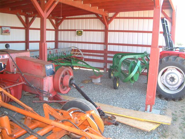

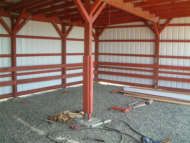

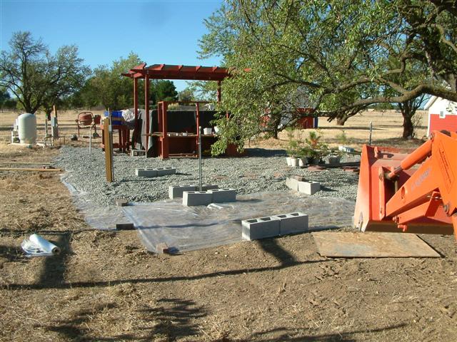

I'm thinking more about building a pole barn but can't afford a concrete floor right now. I did want part of it to be kind of an office/lunch room though. Is a wooden floor built over the clay/gravel a viable option? I've read some conflicting info. I'd like to have 400-600 sq. ft. of office space framed in and possibly have storage on top of it.
Use gravel over 6-mil plastic. I've done this several times with good results.
Gravel floor in the bonsai garden.
Gravel floor in the equipment shed.
