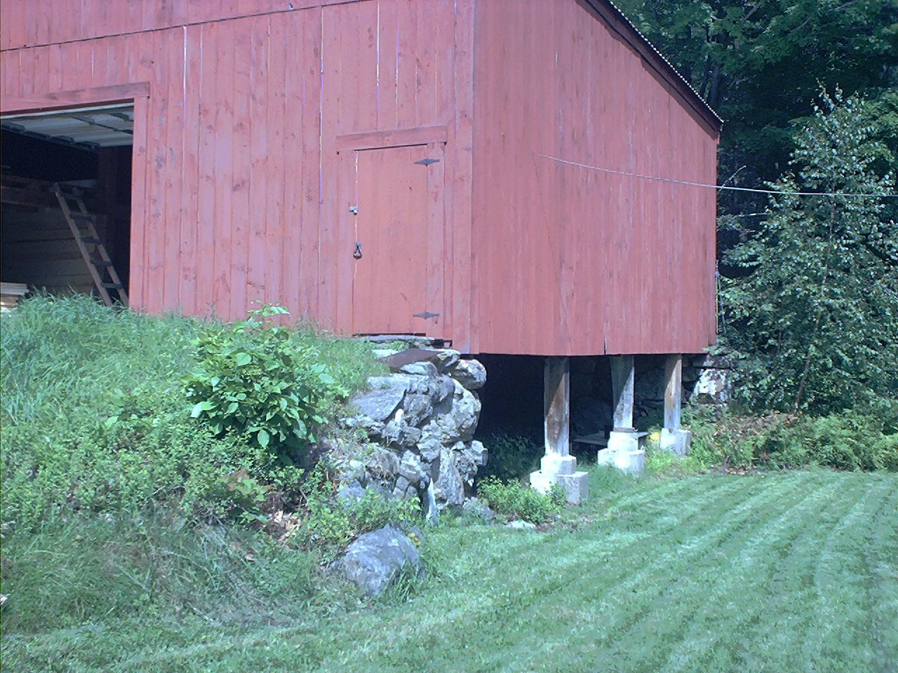

No, there is really no ground floor. The barn is built into the hillside, with the north wall at ground level and the south wall about 5' above. I agree that it's not the best situation, but that's what I got. The stall mats have really been pivotal here. First, they hid the damage to the plywood until it because critical. :( But they have really prevented any injury by keeping the horse from stepping through the damage. I'm going to do a cost tradeoff between the PT plywood and 2x10 floor boards. In either case, the stall mats will be reintalled. The 2x10 floor boards may be prefereable because they'll allow better air circulation to dry the urine that seeps through the joints between mats.

I thought about that, but after crawling around under the barn, I am convinced that the joist failures were just a secondary failure. The primary failure was the plywood, which caused a lateral failure of one joist. With one joist out, the others have failed sequentially. The ply failure was caused by the horse urine, but aggrevated by the fact that the previous owner used 3/4 sheathing instead of 3/4 T&G subfloor and by the lack of any bridging. The lack of bridging meant that there was no lateral load support for the joists. So I will replace the joists with 2x12's 12" OC and bridging every 4 feet. I am still evaluating decking options..... PT subfloor, composite decking, and 2x10's. Unfortunately cost is an issue because I am covering almost 300 sq. ft. of floor.
These same two horses have been in these stalls for five years. If the primary failure was overloading the joists, I would expect that to have happened several years ago.
