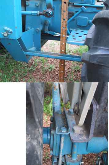

i have found the floorboard a little high, at about 23in. my old TO-20 is about 17, and 3/4in.
yes it does make a difference when you are my age. so i am making a step to attach to
the tractor floor, so it will be easier to mount, and dismount. anybody else have this problem?
william l. brown, in wright city, mo.
   / floorboard high on L3000DT #2
Bill, I had the same problem of a high step-up on a Ford 1910; the platform is 24" off the ground and my step reduced it to 18". Conveniently the rear loader bracket ( 1st picture) had a slot that was the same height as the underside of the rear axel with a small spacer (2nd picture). The channel iron I used is also a great to scrape the mud off your shoes ! Every tractor would be different depending what you got to work with. Obviously, I never take the loader off.
I don't know your age, I'm 62 but my knees are a lot older !

i plan to make my step from square tubing, this is easy to work with. plan to make a
weldment, and then bolt it on.

JOHN,
i can make a step from the material i have on hand, and for a lot less than $60.00
the pictures you sent give me some new ideas. thanks for responding.
william in wright city, mo.
