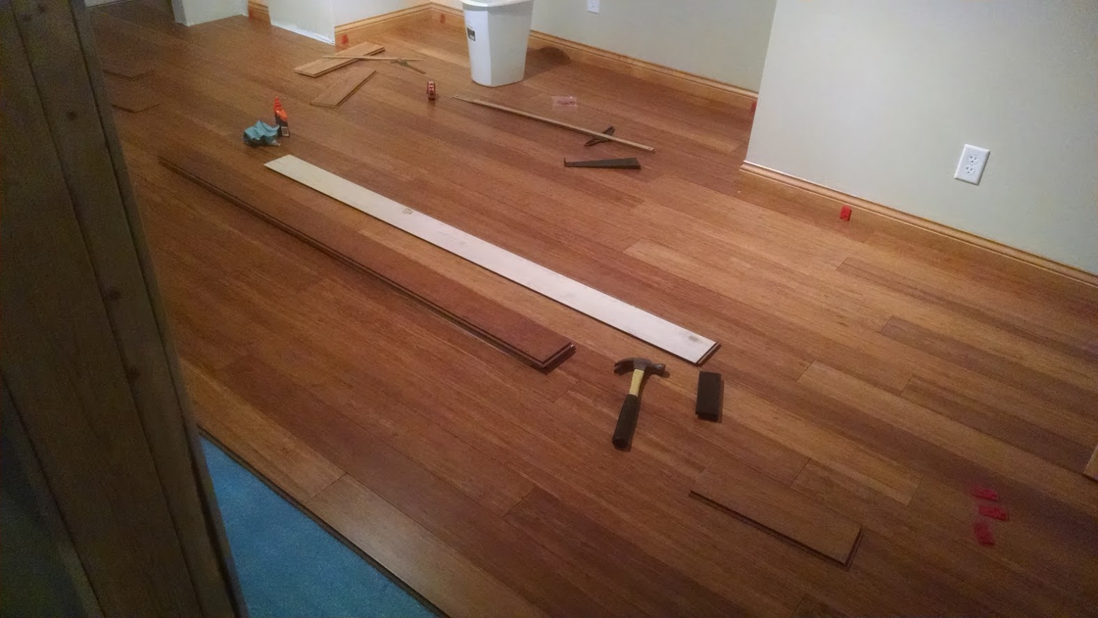

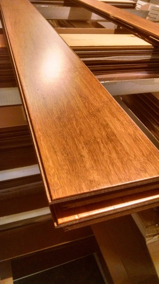

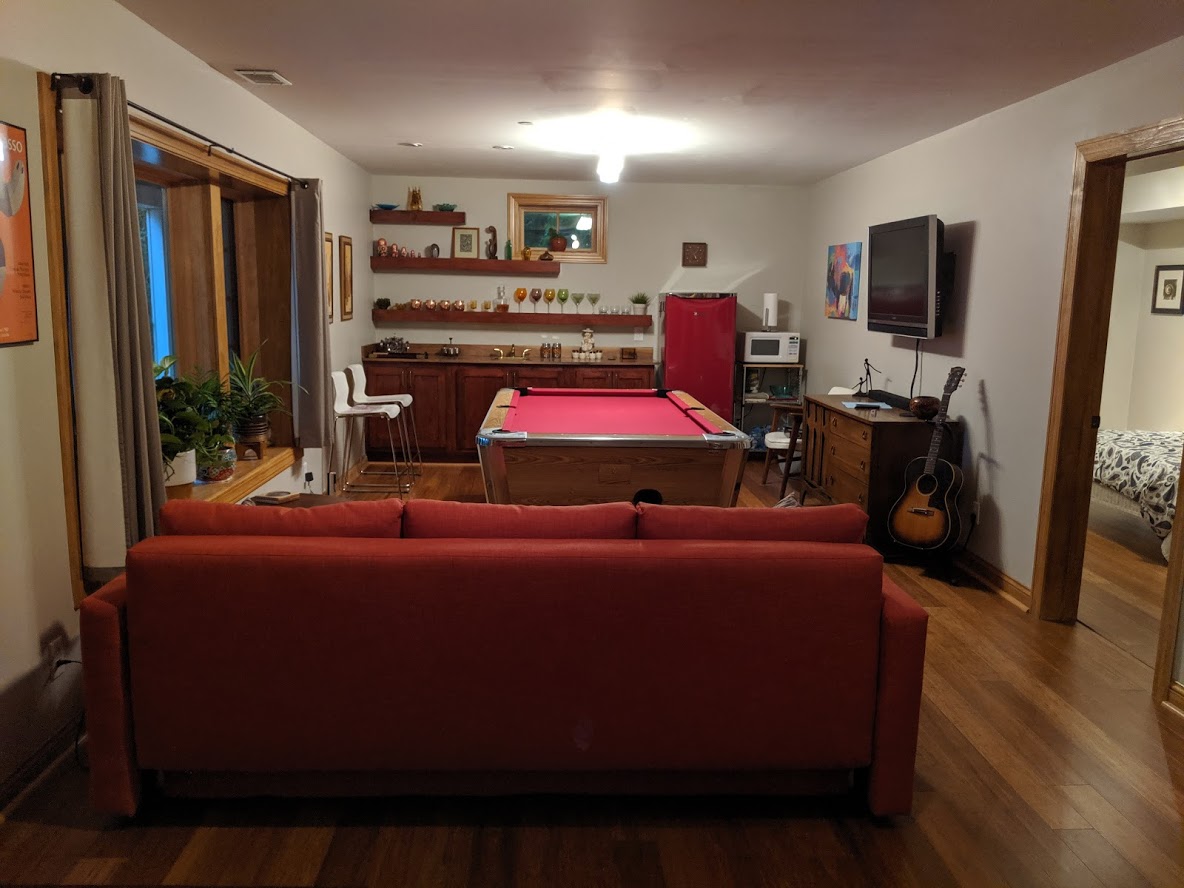

I laid down bamboo in my basement. I think I paid something like $2.50 / sq ft at the time at Home Depot. Going on 4 years now, still looks brand new, this wonderful flooring.
IMG_20161103_172313972_HDR.jpg IMG_20161111_181412577.jpg IMG_20191026_170727.jpg
There are different types of bamboo flooring, this stuff we got is strand woven, the claim is that it's way harder than oak flooring.
I found underlayment prices to be way too high at home improvement stores, I had better luck on Amazon. I got a 3-in-1, 3mm thick. Like I said, it went in the basement, on concrete. Being upstairs, you'll just need a 2-in-1.
