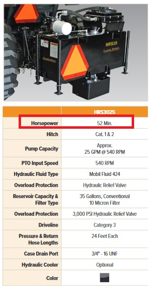

A caution would be to make certain you have the pto power needed for the new power pack.
Landpride's unit needs 52 pto hp to produce 25 gpm at 3,000 psi.
While that seems to be right at the limit of your tractor's pto
ability, you wont have any power left for moving the tractor.

Thank you for the replies folks. Greatly appreciated.
For my tractor and implements, a 20 GPM/3000 PSI 3-point-hitch power pack would work well. Does anyone know of a driveshaft (as opposed to the pump directly mounted onto the tractor's PTO) unit available? (The only one I found is John Deere and it's they apparently are not taking orders for it.)
The LandPride HRS30 looks really nice, but as pointed out a 25 GPM/3000PSI pump is at the very maximum of my tractor's available PTO power. Which leads me to a $64,000 question...if an power pack like the HRS30 was used with a flow control valve set to 20 GPM, would the load on the PTO drop accordingly?

Presuming that power pack has fixed displacement gear pump the flow control will not reduce HP required since all of the flow will be at what ever pressure the system requires
I must admit I thought otherwise...but the more I think about what you said the more I think you are correct. There would be less power to the implement, but the load on the PTO would stay essentially constant. If true, it sounds like all I would be doing is generating heat! 😟
/ Flow Control Valve #10
Joel
Yes The highest load will dictate pressure at the pump or flow control inlet any excess oil being returned to tank will be energy loss or heat. Usually not a big issue on system that requires momentary flow like cylinder operating but when continuous duty like running a motor the heat generated can be a concern.
