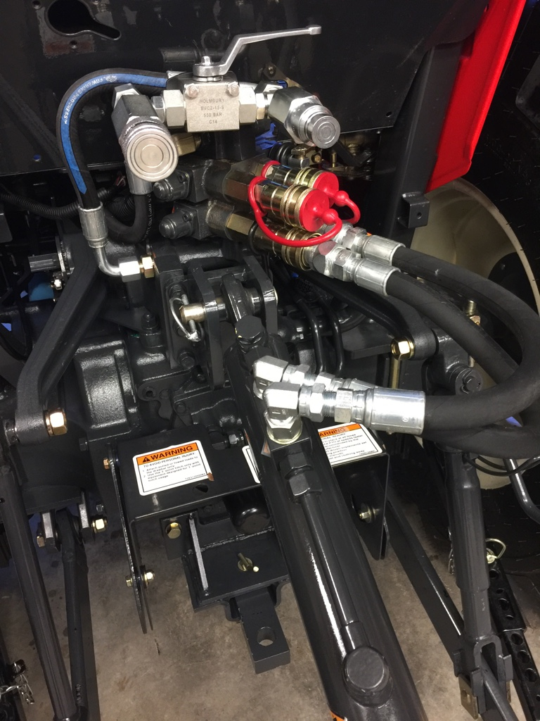

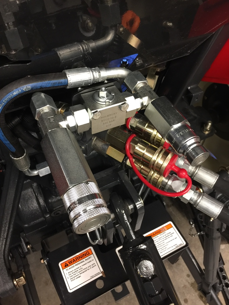

The flow goes through all the valves in series. Pump -> loader -> 3pt. On each valve the flow goes out the tank port or PB port if the valve has PB, and on to the next valve. Unless the valve is actuated, then flow goes out the work ports. When you operate the 3pt, the pressure to run that comes from the pump, through the loader valve.
Now add an additional valve: Pump -> loader -> new valve -> 3pt. The pressure to lift the 3pt goes through the new valve. If you plumb it without using PB the tank port will see that pressure, which maxes out at about 2500 psi.
There are valves with tank ports that can handle full pressure. The dealer installed additional remote on my 3725 is one. But they are not that common.
BTW the last time I heard the factory remote kit was a lot less than other manufacturer's remote kits. With all the stuff you'll need to buy to DIY, easily another $150, plus fabbing brackets, it might make sense to price the factory kit. It does integrate nicely in the cabin.
I'm slowly getting the picture, I think, there is still confusion as to which tank port sees what pressure. From what you're saying, the new valve's tank port would be subjected to the full pressure and it's not rated for that. The one that must be rated for the high pressure would then be the one on the backhoe. It's here that I think is confusing me, the backhoe has only one port or outlet used since there's only two lines to/from it. In your case, you don't have a backhoe, but you have the added valves and it's their tank port that can handle the pressure?
What I would need to do then is to find a way to connect the tank port to the tank? I just did a request for the kit, might be a viable option

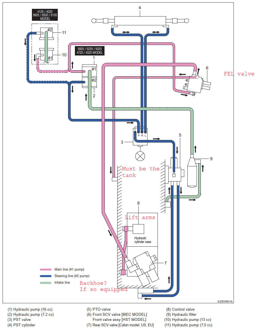

It's the powerbeyond and tank operation and how the backhoe lines are different somehow I think?. Say you only have one valve, the FEL we'll say, if you refer to the updated diagram, it shows a tank return and a powerbeyond, but since this is only one valve, it won't be connected. So, when you're not operating the FEL, there won't be flow, right? Or, is it the case that the PB will always be connected to something? The diagram seems very incomplete, the FEL valve is the only one showing a tank connection. If fluid has to flow, then the 3pt valve must have it's PB connected since if you're not FEL'ing or 3pt hitching, or backhoeing, that's the only way for it to go. But connected to what?
As to the backhoe, it has either no tank line or no PB line, there is only one hose in and one out. Was that just cost reduction and the fact that the 3pt can't be used when the backhoe is on? The necessity for flow would seem to mean its PB is connected to the out line for the case that the backhoe is on but you're not using it, but that really begs the question of what happens with the fluid used when you're operating it?

Forgot the drawing
trx-cap --  - 12_10_2021 , 14_09_26 - Branson 20 series service manual_ - PDF-XChange Editor.png

It's that stuff in red that is confusing. How does that work? If the 3pt is raised, the fluid used to raise it goes out to the tank. What's happening with the fluid when it's not getting used and returns to the tank? At that point, assuming nothing is being used, don't you have a continuous route from the pump to the tank through the various PB connections that would expose the line to atmospheric pressure?

When you raise the 3pt the valve diverts flow to the cylinders inside the transmission case. The fluid fills them and pushes a piston which turns a shaft that exist the transmission case and rotates the arms to pull up the 3pt linkage. When the 3pt is not moving, all the flow from it goes out it's tank port, which dumps directly into the transmission case/tank.
When no valves are being operated the fluid just flows from valve to valve. It's not doing any work so the pressure is just from resistance in the hoses and valves, i.e. pretty low.
I have a BH and the two factory remotes and an additional dealer added remote. The BH's valve stack has only a tank port, no PB. And if you use the 3pt with the BH connected and get the pressure too high you can damage the expensive BH valve stack. Normally that's not an issue since the 3pt arms are off and there's no room for an implement, and the position control does not let you dead head the 3pt at the end of its travel like the simpler spool valves for the loader or more basic types of 3pt controls.
