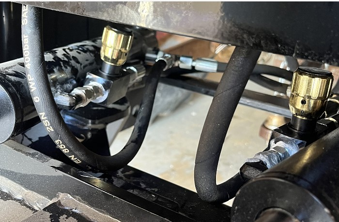

I put the 5gpm valves linked above on various circuits on my Branson backhoe. The boom was way too fast and jerky. The bucket curl speeds up as it reaches its stop on extension, slams into the stop and ejects much of the material in the bucket. I can get it right about half the time.
I put the valves on the cylinder ends of the hoses so I could get to them to adjust them. There's two on the boom cylinder and I can reach them from the operators seat.
I'm not an experienced backhoe operator but I have about 20 hours on this one. As I got better I could operate multiple controls at once but that wasn't enough to make the boom or the bucket curl behave predictably. Selectively slowing the hydraulics helps. I think the valves on this backhoe are just cheap.
These restrictor valves are one way. I set them up to restrict flow out of the cylinder. JIC5 is usually on a 5/16 hose. It's its own standard, not SAE or NPT. You'll need NPT to JIC adapters for the valves, one male and one female JIC with male NPT on each.

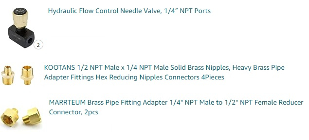

Thanks for the information. So these are the adapters I ordered for the control valve below.
   / Flow Control #18
Please cancel that order ASAP. Those fittings are not meant for hydraulic pressures at all!! Get proper hydraulic fittings that can handle thousands of PSI.

Ok they have been canceled. I'm going to visit our local tractor shop and see that they have.
