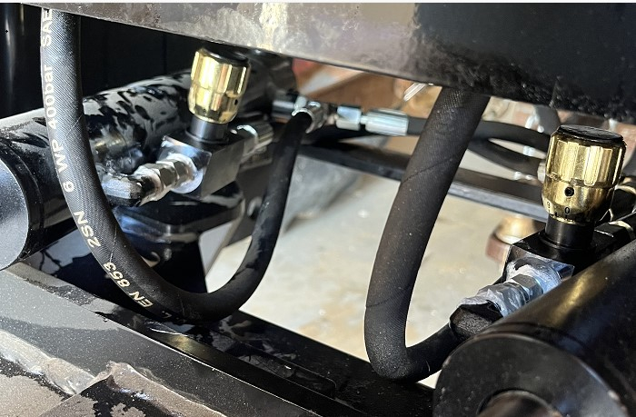

Update: So I finally was able to find the needed adapters to attach my flow control valves. I had to mount them by the hydraulic shocks because there wasn't enough room in the
valve box once the adapters and valves were included . I had the flow set to 0 when they were once installed and opened them both 1/4 of a turn. started the tractor up and boom!, the response was just about to where I wanted it. Ill probably play with them some more to get it right where I want it.
Once again , thanks for all of the help with this!
/ Flow Control #27
Nice! Thanks for the update.
Nice and neat installation too. Doesn't look like it's to hard to reach and adjust if needed.
