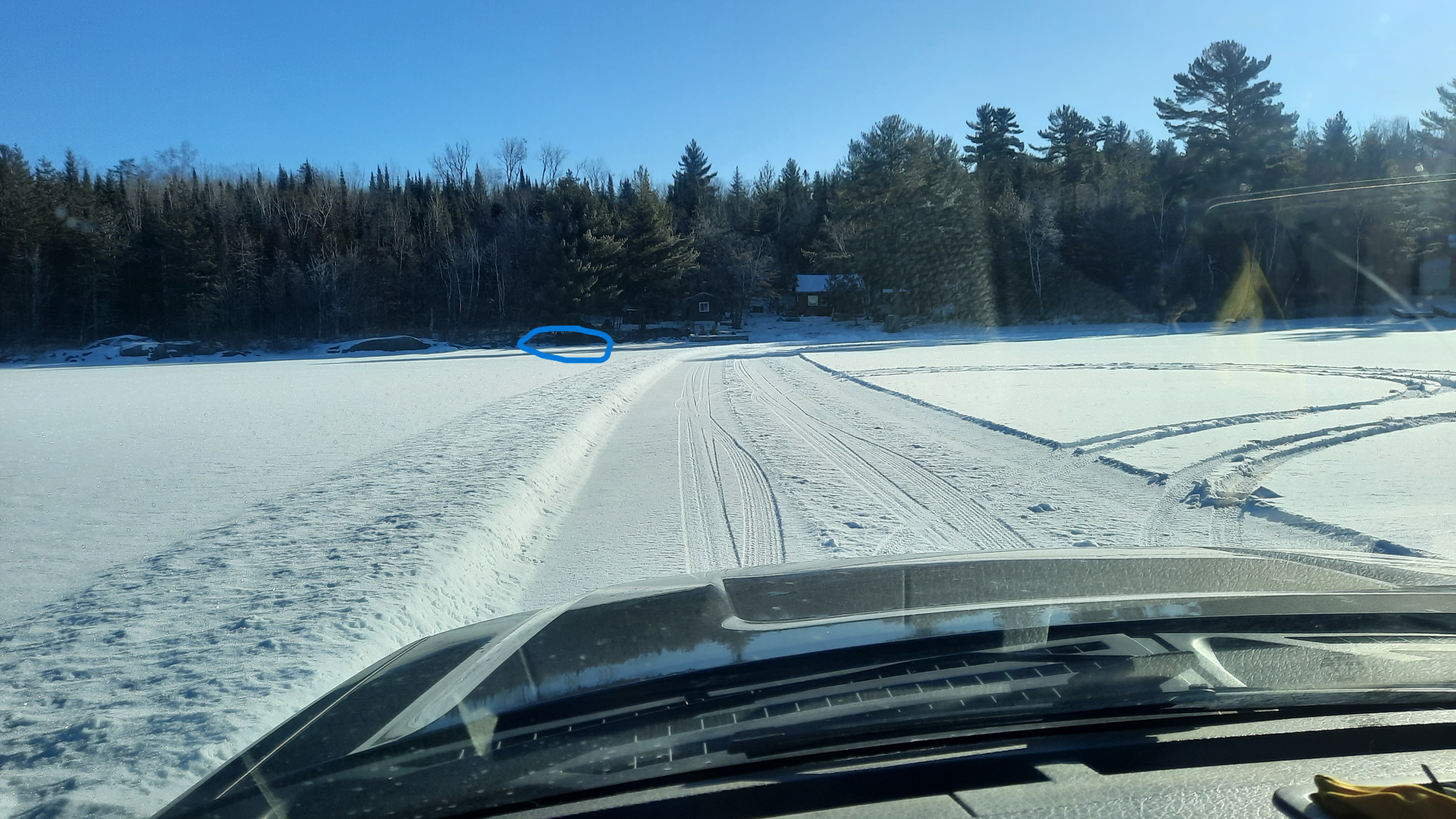

There is a 360 sq/mile "Pond" 125' from the flow, no real need for another Pond. No need for permits either
The flow would hit the Lake about 40' to the right of the dock

#16
Right about the marked area
