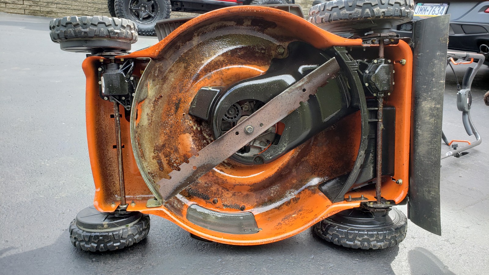

I've been using Fluid Film on undersides of mower decks for a couple years now after reading on MyMowerForum about it. Some of the professional lawn service folks were saying that it stops rust and also inhibits grass from adhering to the deck. So I pressure washed and cleaned the deck of my push mower last spring and sprayed FF on it, let it set and dry a week and then gave it a go. It really helps. I still get a light amount of grass sticking around the bottom edge where the deck is stamped with an outward bead for stiffness, but I hardly get any grass at all sticking up in the air chamber areas. I've committed to myself that this fall I will pull the decks from my 2 garden tractors and pressure wash them and fluid film them for next years service. I hate doing the every 2 week deck cleaning on the tractors. Hopefully I get a similar effect as the push mowers and I can be lazy with regard to deck cleaning.
Photo of fluid film applied heavily to my Husqvarna HU800AWD deck is attached.
