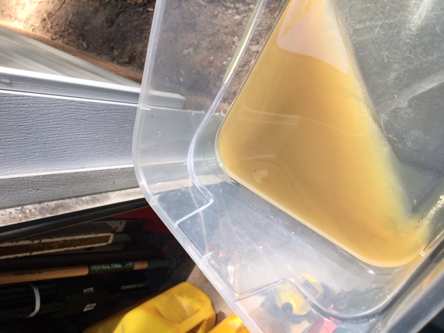

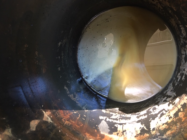

The black bucket has the fluid that drained out of the cylinder 2 days ago. I tried not to stir it up when I rotated the bucket to show the white residue on the bottom of the bucket. The second photo is fluid I just now drained out of the drain plug, and it's cloudy too. I'm going to change the fluid and filters. Thanks for the help. DRAINED FROM TRACTOR 05-09-20.JPGDRAINED FROM CYLINDER 05-07-20.JPG
   / Fluid in hydraulic cylinder is milky but in rest of tractor, fluid is clear. #17
The black bucket has the fluid that drained out of the cylinder 2 days ago. I tried not to stir it up when I rotated the bucket to show the white residue on the bottom of the bucket. The second photo is fluid I just now drained out of the drain plug, and it's cloudy too. I'm going to change the fluid and filters. Thanks for the help.View attachment 654664View attachment 654663
Its bad change it.........
   / Fluid in hydraulic cylinder is milky but in rest of tractor, fluid is clear. #18
I AGREE--CHANGE THE OIL. GET AS MUCH AS YOU CAN OUT OF THE CYLINDERS. RUN IT AND LET IT SET FOR A WHILE IF YOU CAN. THE WATER THAT IS LEFT WILL SETTLE TO THE BOTTOM OF THE TANK. DO THE DRAIN PLUG AGAIN AND LET IT DRIP UNTIL THERE NO LONGER IS WATER. CHANGE THE FILTER AGAIN. IF THERE IS VERY LITTLE WATER FROM THE PLUG OR FILTER, DRAIN THE OLD FILTER WELL, RINCE WITH NEW OIL AND PUT IT BACK ON. IMHO
