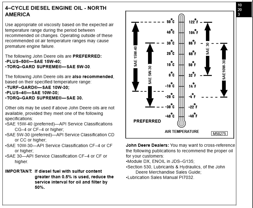

Hello, I appreciate the add to this group. Can someone share what the best Oil weight would be for upstate NY in the Cold Country? I just bought a Yanmar 276D and want to change the fluids before I use it. With colder days arriving soon I want to use a Fall/Winter weight Oil. Also I would like to know what most use for Hydraulic Fluid/Transmission Fluid. Lastly, what Filters should I use? Can someone provide part numbers? I will log them in my files. Thank you!

Calls for 15w40 diesel oil. If you want to use a lighter weight for winter it should be fine. just make sure it's diesel rated.
JD 303 is the spec. for hyd oil. you can buy the off brand that meets jd 303. tractor supply brand, etc,.

Thank you. I appreciate the reply. I have the Operation Manual but not a Service Manual. I didn't understand the Oil break down for the temperature change. I did see the referene for Transmission/Hydraulic Oils with JD 303 (J14B). It looks like the engine oil calls for SAE 20 but no multi-viscosity above 32f. I'm not sure I understood that correctly.
   / Fluid Questions for Central NY State #4
well, Oil has changed a great deal since those tractors were built. So I think you would be better off using a multi grade oil for colder temps than a single wt oil.
Perhaps 5w40 synthetic diesel rated oil, or similar

Oil - the manual is 30 years outdated. Ask a farmer what Diesel-rated viscosity you need to get it to crank in your cold climate. If you can get it started then any multi-grade Diesel oil should be fine.
The manual says use JD 303 equivalent Universal Transmission Fluid. An obsolete spec. What's sold under that description today is the lowest-spec, non multigrade fluid. J20C is the Deere multigrade UTF spec that superceded 303. That, or better, is my advice. ATF is another good choice. These Powershift models should get better fluid than the minimum-spec stuff that is fine for a manual transmission.
