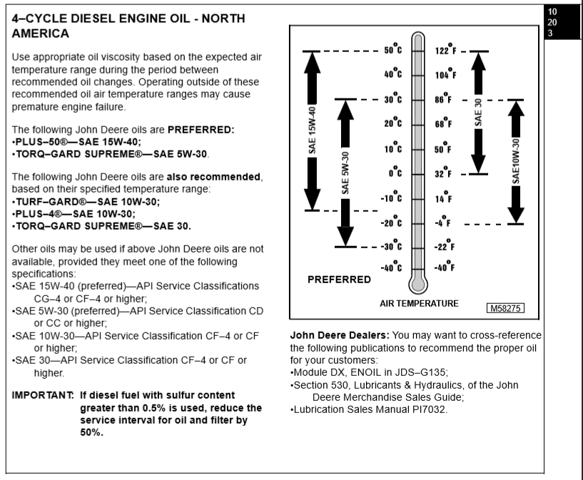

For cold weather in WNY along the 2 Great Lakes, Yanmar shows 10W30 & John Deere lists 5W30 for our YM series engines.
I tried the 15W40 last winter. It was a real PAIN getting the engine going. If it had a oil pan heater, then maybe. By the end of December, I switched over to the 5W30 and it was a joy once again running the engine. I had to move so much snow.
Yanmar Self Check Tractor Maintenance doc 2/18/2014 Yanmar.com.jp for the YM series.
John Deere Diesel Maintenance for 650/850/950/1050 with Yanmar engines

I tried finding the source for those upper temperatures/oil. Do not make sense. The engine upper operating temperature is set by the thermostat, typically 180-190 F. Think the charts are for air cooled engines.
I use 5w30 diesel rated oil in the JD and Isuzu from the VW dealership. Can get 0w30 M1 ESP (exhaust system protection) online for about the same price. When I run out of the Castrol 5w30, the M1 0w30 is what I plan to get.
Use 0w20 in the 3 gasoline engines.
Have 5w30 regular M1 for the air cooled engines.
Racing engines typically use 10w oils (I've read on forums), and they would get pretty hot. Think they do this for protection for max. performance without killing the engine right off the line.

Those charts are for liquid cooled engines. Look up the John Deere models on tractordata.com to verify for yourself.
I'm not a fan of SAE 30W straight. Thus, if you live in an area for temps hotter than 87F, the 15W40 on both charts is defined.
If you know your oils, you can do a syn 10W30 mixed with a zinc additive for engine protection. This would allow it to reach the hotter temps. The sny will not break down like dino.
