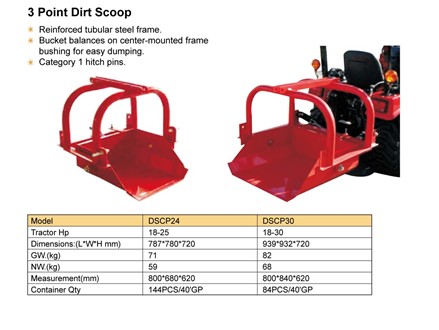

It should be Cat1. Measure the diameter of the hole on the lift arm and check this chart.
Cat 1 dirt scoops are made in different widths, 24" and 30" are the most popular sizes.

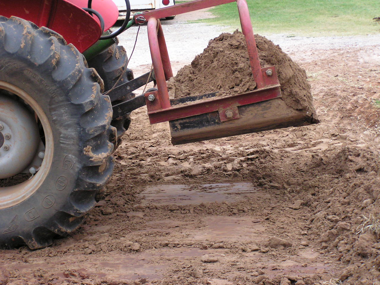

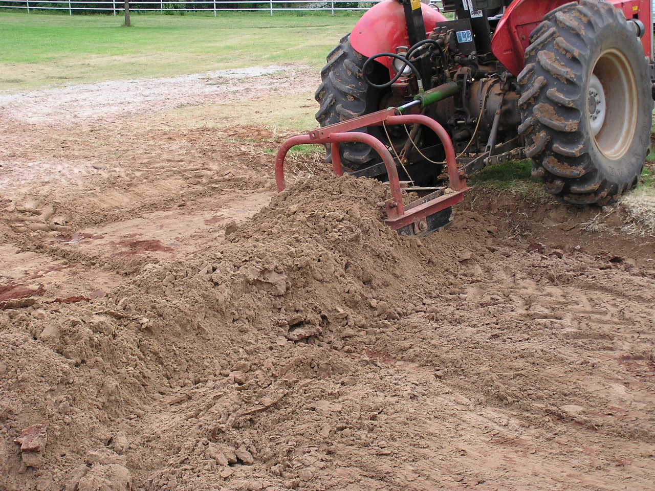

Your'e welcome. If you will be using it a lot, get a hydraulic top link, makes it more better. :D
This is from ten years ago, when I had a tractor. The scoop was 36" wide.
