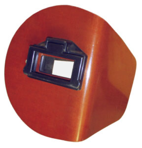

I'll have to ask if they have a special breakfast menu for welders the next time I'm at Wendy's.:D They use square hamburger patties cause they don't cut corners but their pancake hoods are round. What's up with that.:confused3:
Rubbing dish soap on the lens until it disappears also helps to reduce fogging. A lot of pipeline welding in winter is done inside a tent or a special shack that is lowered over the pipe. They don't just start welding on the cold pipe. They have to preheat it and the shacks have heaters as well. You have to be a bit of a contortionist to weld pipe and it would be very hard to do with bundles of clothes on to keep warm.

Pancakes are for right handed or for left handed. They are flat front and bent to cover one ear. Glass is in a face plate ( like goggles) only goes around eyes, must be fitted to face. Does not flip at all. Lift off eyes or put on eyes. Sarge is another one.

Never seen these pancake welding hoods before, and I been around welding a lot, do these hoods have a flip up lens?
The old ones were built on the style of a pair of cutting googles and had to be raised up and down the same way. Most places now wont let welders use them as you have to have a hard hat on when welding and no way to use them with a hard hat. I am glad I stopped welding about the time they(Brown & Root) required use of hard hats. They sure made it hard on the neck due to extra weight and when getting under the bottom of a pipe when you had to lean sideways and the hood wanted to slide to a vertical position unless it was tightened so tight on your head that your head felt like it was in a vise. I think they finally got some hard hats made to weld in that helped a bit and were a bit lighter but the first ones were just a clamp on band like a face shield and a regular hard hat which wouldn't stay on your head at all.

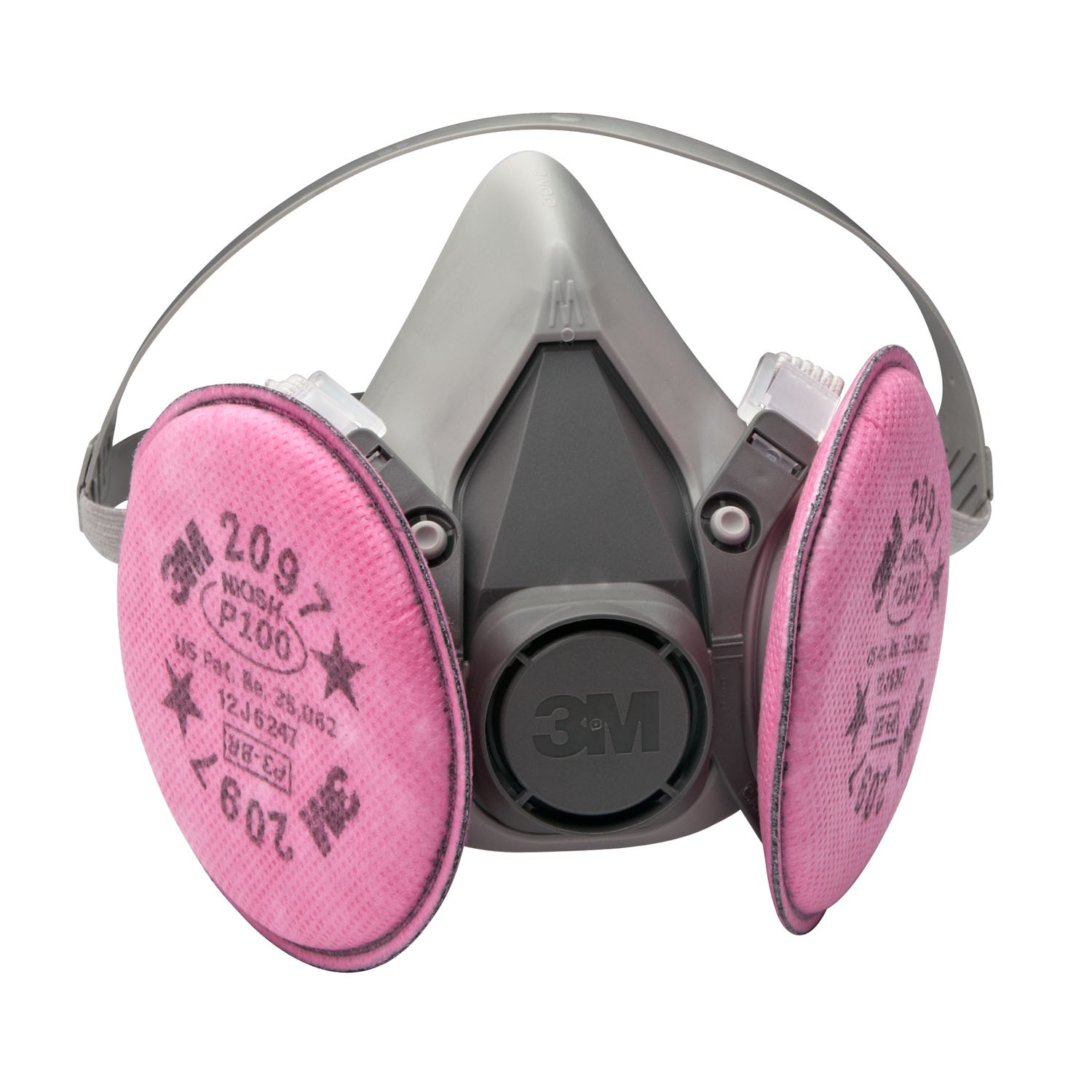

I wear a respirator the entire time I'm in the garage because I switch back and forth between cutting, grinding, and welding. It exhausts out the bottom, so nothing fogs.... keeps the black boogers away too! : )
Those are good respirators that you posted pic of... issued at shipyards, and I also use at home.

Lots of great ideas. I'm going to give the respirator a try.
Years ago I remember the welder I was working with makingnhis own from a pair of welding goggles and some cardboard and duck tape. Had a weld in a tight spot close to a wall so he put a #10 lens in those gas welding goggles and cut some cardboard to shield his face. Worked well for the couple joints he had to make but wouldn't hold up too long. Still, in a pinch it worked and cost was near zero.
