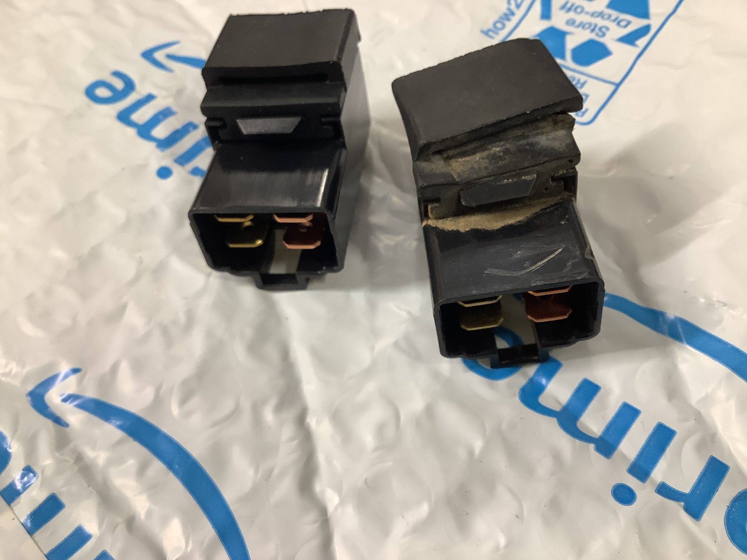

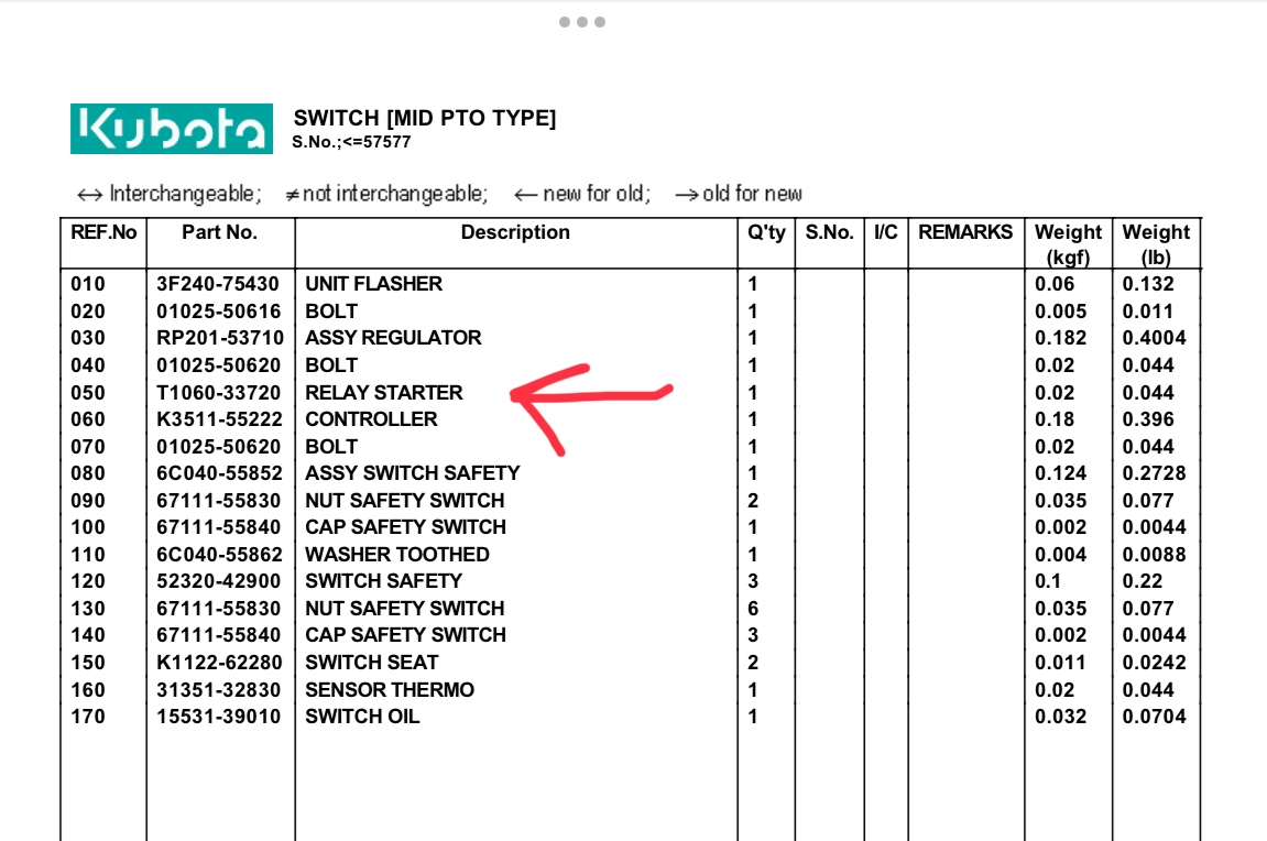

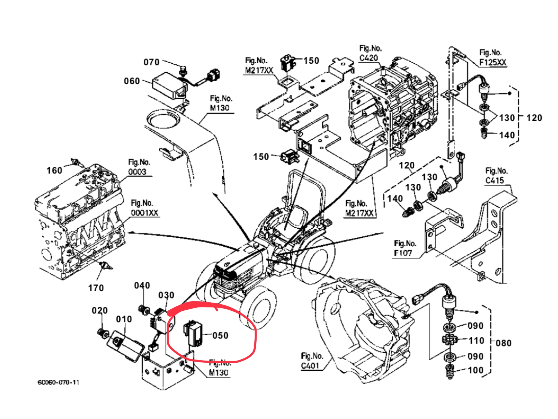

After months of intermittent crank but no start with no fuel stop solenoid “click”, finally fixed it by replacing the relay, ACA12115 (CA1a-12V-A-5) located inside the dash and beside the tachometer cable. Checked all grounds and even got a new battery. The solenoid passed a bench test with 12v applied, but replaced with OEM one anyway and the problem still persisted. Then searched here and found reference to the relay and ordered a compatible one off Amazon. Tractor started right up. Will repost if problem returns.
Lessons learned: Tight clearance on the inside 10mm fuel stop solenoid bolt, but a 1/4 ratchet and deep socket worked. Loosen the tachometer cable clip under the hood for slack to remove it and the dash guages for access to the relay plug (circled). Do not have to remove the lower dash cowling. Hope this helps others as prior members comments helped fix my issue. Thanks all.
