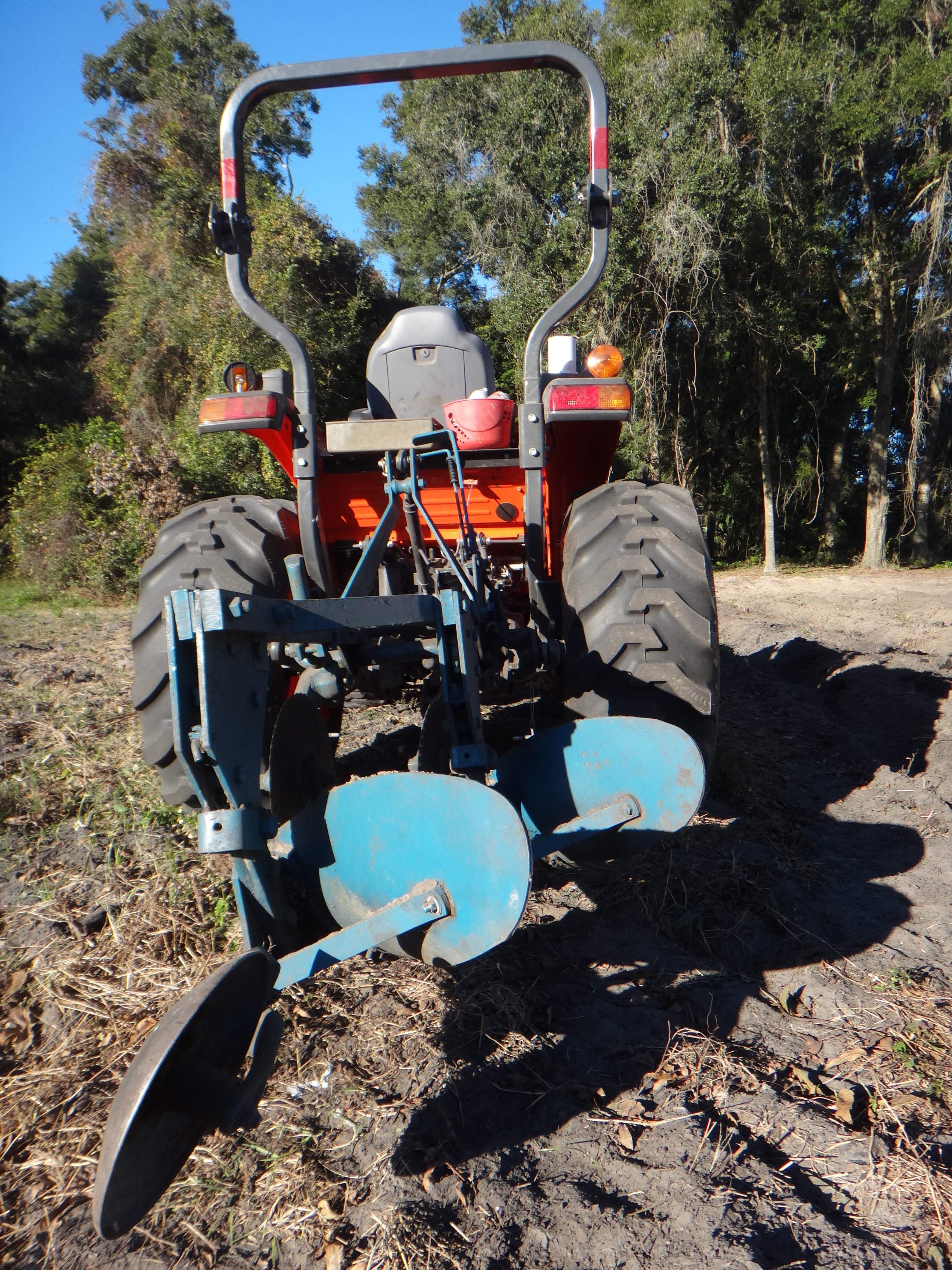

I'm a complete novice, so take my observation with a grain of salt.
It seems as though the stumps will be a limiting factor for anything more than casual food plotting. If you need to till deeper, the stumps would be a nightmare for certain tilling equipment. Would there be a way to identify the stump locations by dragging a disc, mark them, then pull them out with a backhoe? I'm not sure how many stumps were talking about over the course of 30 acres, but if you're saying they're all roughly 15" or less, a backhoe would make quick work of them. This could also necessitate grading the field back once everything is pulled.

AMCO disc is a beast, its cutting the stumps or going over them. Already made multiple passes on a few acres no damage. I plan to put a vid on you tube soon.
