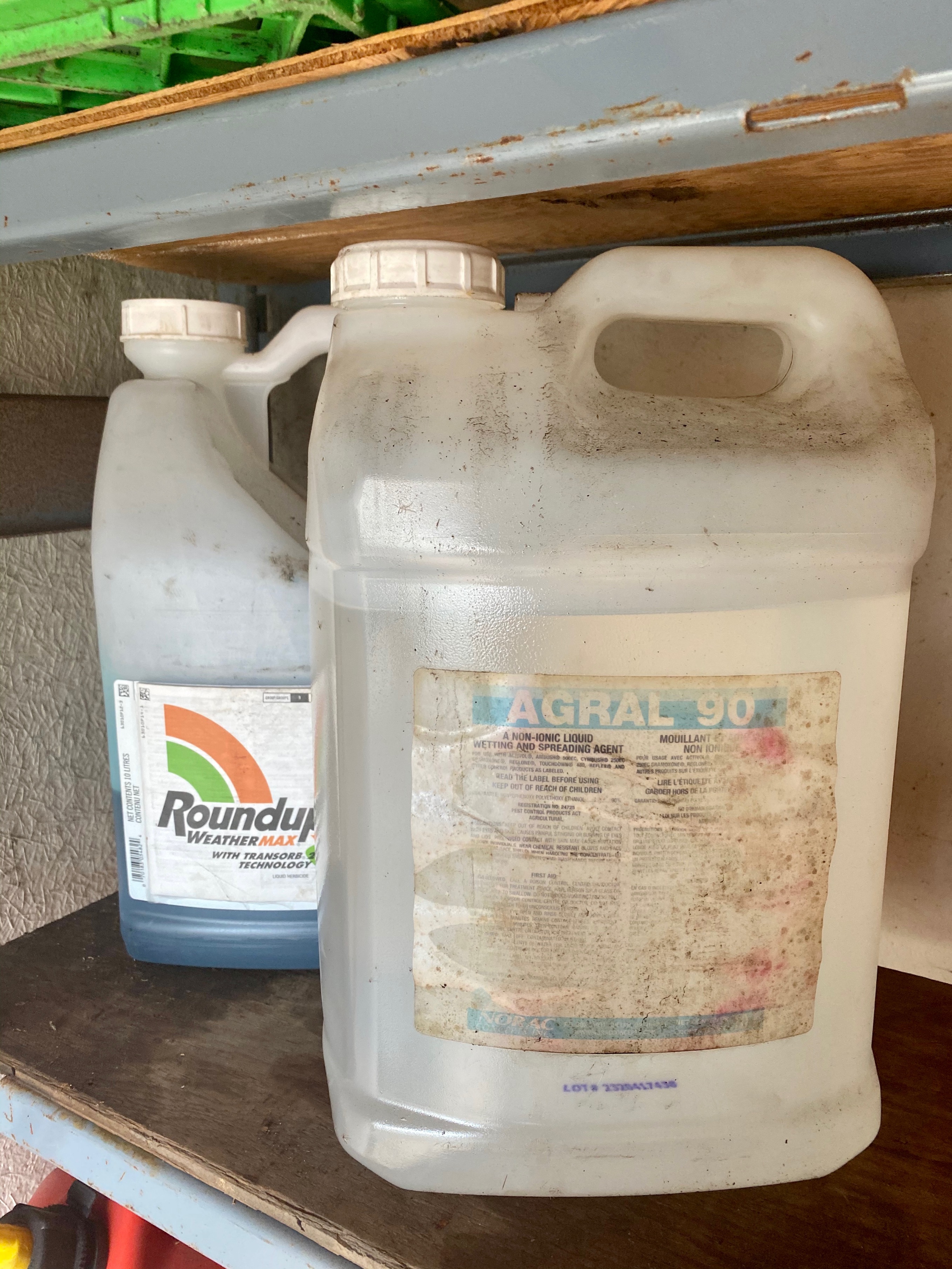

And if any chemical requires a surfactant make sure you use it. It’s cheap and can make a huge difference in performance for some herbicides. Glyphosate is one for sure that benefits. Basically it allows the chemical to better penetrate the oily surface on some plants.
Agreed. My Roundup label says it contains a surfactant but I ALWAYS add anyway.
The funny thing is the off brand Glyphosate must not have it included. The reason I say this is because it never seems to work as good as the name brand products. It’s a good bit cheaper at least here in Virginia and has same strength. I mix at same rate but it never seem to performs as well till I started adding a little surfactant a few years ago. Now it smokes everything every time. Surfactant is so cheap and you use such a small amount it’s still a lot cheaper going this route vs the name brand product.
