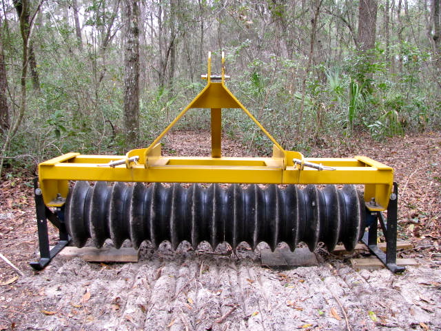

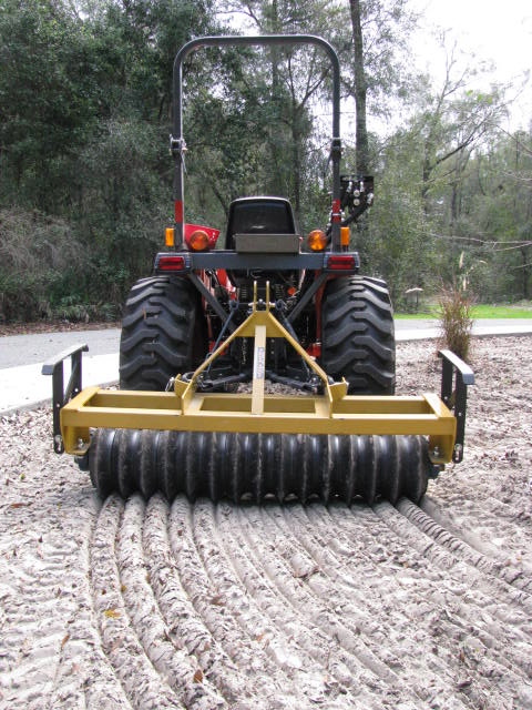

Where I am in North Florida it is important to roll in your plot seed. We have two month Spring and two month Fall dry periods and rolling improves germination if weather does not cooperate.
For years I pulled a Brinley water-filled plastic lawn roller behind my Kubota B3300SU. Took off the lawn roller rubber grips and inserted one length of 3/4" all-thread in each end of handle, inserted all-thread in 3-Pt. "eyes" then secured with washer and nut on each side. Roller filled in space between tractor tires giving total roll width, with tires, of 58".
Roller available from Home Depot/Lowes, yard sales etc. Meant to be pulled/push by "hand" so frame is not strong enough to withstand REVERSE on tractor. Forward works fine. I carried roller to the food plot in bucket, then nutted into "eyes".
Recently purchased a 60" Cultipacker from Everything Attachments. I am not sure germination will improve but intend Cultipacker will cure persistant erosion sites by rolling crimp pattern across slopes after seeding.
Tractor is a Kubota B3300SU / 33-hp / 1,900 pounds.​
