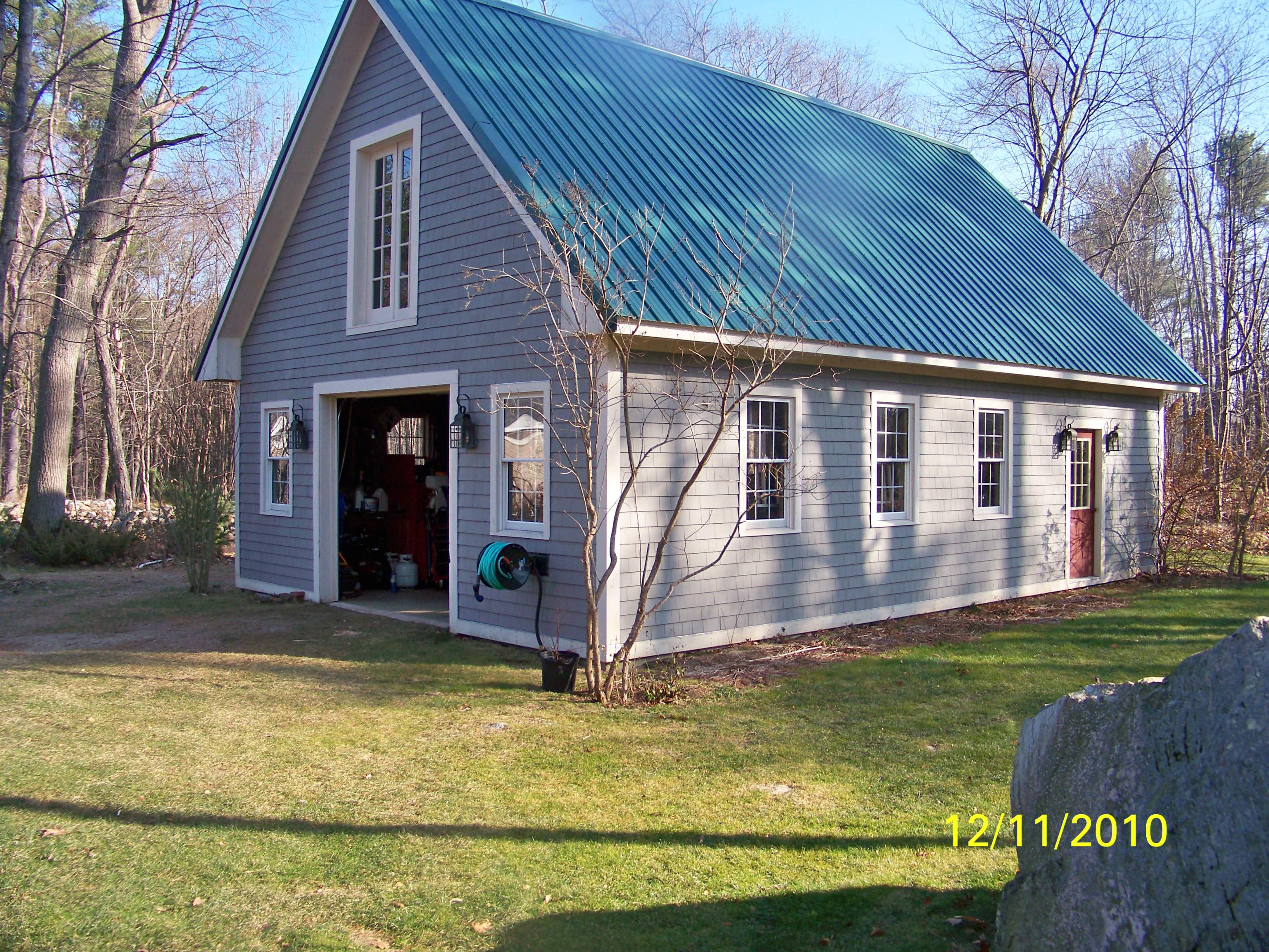

I would consider monolithic slab construction - essentially you scrape off the top soil and level the area, then dig a 24-30" x 18" wide around the perimeter, then add some crushed stone on the entire area, compact that and then set forms and rebar. The monolithic slab with a 18 x24 perimeter and rebar with a 6" interior concrete with the rebar will hold up in most climates.
It does depend on your subsoil and location - for instance you wouldnt do a slab on a 20 deg sidehill.
One last point about the size of your structure. It doesnt cost a lot more to do 24x36 than 16x24 and while you are at it build it big enough. Attached is my 24x36 mono slab build - two story clear span - no support posts on first floor.
