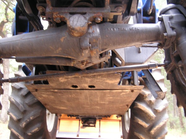

asked about seeing the skidplate I made for my TC45 - here's pic 1 -- poorly made holes for oil drains ... oh well they work
   / for oldtimer65
#2
pic2
   / for oldtimer65
pic3
   / for oldtimer65 #4
Good photos. It looks like that should work fine. The cc drain holes look OK to me.
I located some inexpensive stainless 3/8" J-bolts, nuts & washers at a hardware supply in Nebraska. Had to open the J a little to fit on the loader frame. Now to get the plate material.
Thanks Mike
   / for oldtimer65 #5
Mike bolting the skid-plate to the BH sub-frame was a right good idea. Thanks for sharing those pictures.
