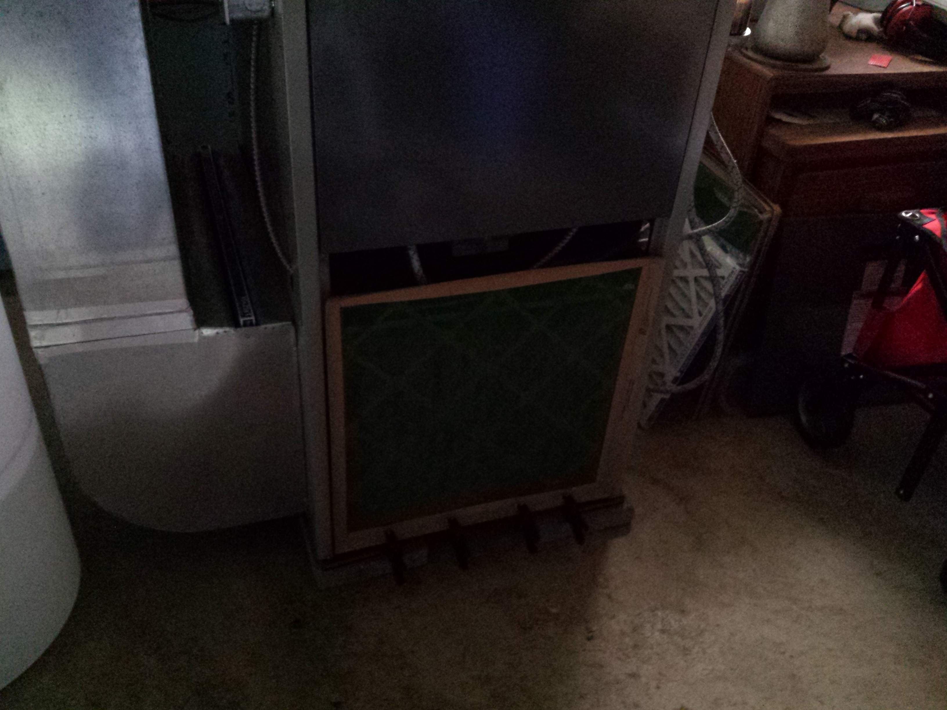

During the summer I take the front cover off of my furnace blower so it will move the cool basement air through the house when I turn the furnace fan on. As you can see in the photo, I put a filter on to trap some of the dust.
Our basement is above ground and I usually leave the door open that leads up to our living area. So we don't have any type of air flow or negative pressure issues.
During the winter I use a pellet stove in the basement. Would keeping the front cover off of the furnace help move some of the warmer basement air up through the house as well?
By having this front cover off is it harming anything? Will it shorten the life of the blower since it is not pulling as much air from the return duct run?
Thanks for your thoughts.
Wes

You will have to take what I say and see how or if it applies yo you. I can't see the pic very well. Don't let dust get into your system. It will clog your AC coil and get into your ducts and just make a mess. How ever you do it keep it filtered. Ed

I have a wood furnace with its own forced air blower (Charmaster). Install instructions say to never run the blower with the cabinet open because it alters the airflow over the blower motor and can cause it to overheat. Probably applies to regular air handlers as well. The blower motor requires proper airflow for cooling.

Running the blower without the door on (NEVER with a gas furnace) will cause the blower motor to pull too many amps and possibly overheat.
Adding both supply and return openings in the basement ductwork near the ceiling will draw in the heated air from your stove to circulate to the rest of your house.
The supplies are necessary to balance the airflow, so the basement does not become negative in relation to the upper floors- this would cause draft problems with the stove flue.
14 x 6 RA with damper, close to the stove, and two 4 x 10 SA elsewhere will help circulate the heat and work safely!!! 30 Yrs. HVAC experience BTW
