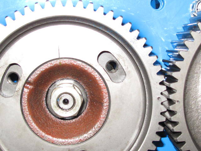

page 17:24 "Align the injection pump gear mark with the idler gear mark by turning the crankshaft counter-clock-wise ......”
I had lined up the marks to set the crank, idler and cam all up but there was not another mark left to align the pump.... but that is not what the manual told me to do. And I was not clear which mark on the idler to line up. But I think if I simply line the similar dots on the idler gear and the pump gear, all will be fine :)

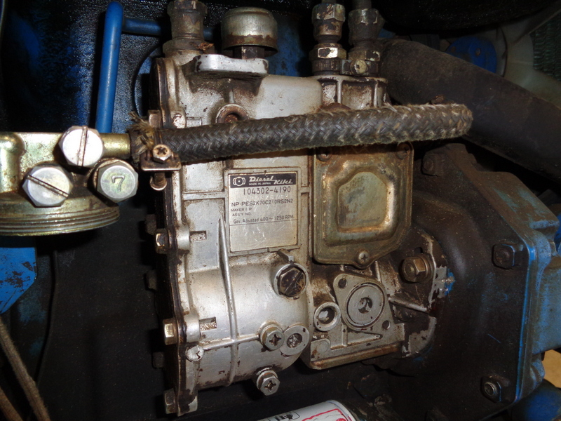

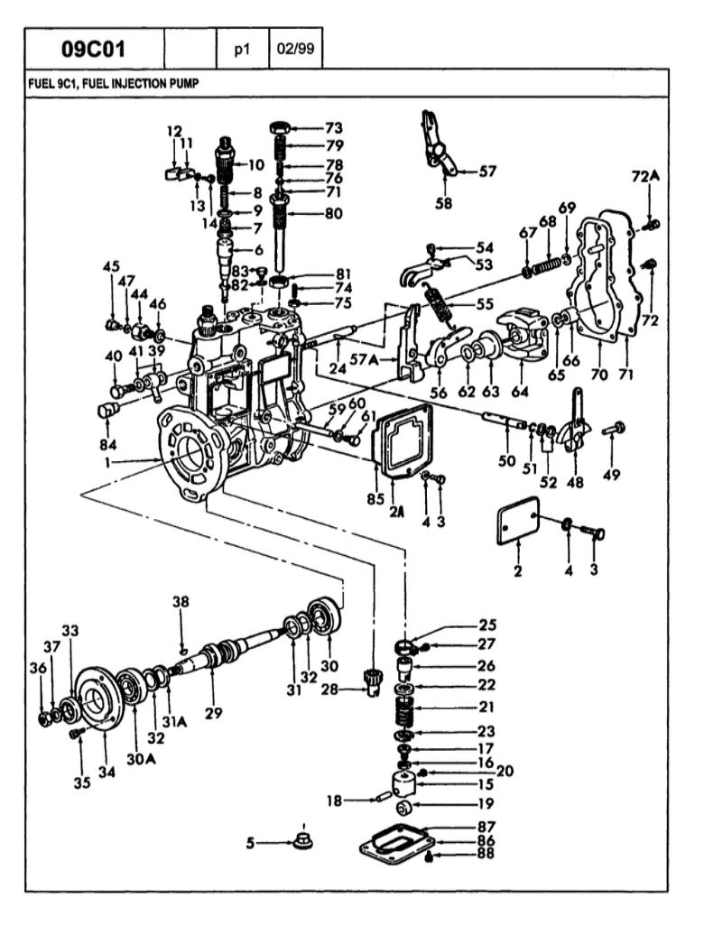

It looks like in your pic that the hi idle and low idle screws are missing.. they screw into the boss on the left..
Another question.. r u pushing on the control rack in your pic.??
Do u have the spring and shims.??
Yes Mike, The idle screw is missing, the parts drawing only shows one, are there two (I assume you are talking #74 and nut #75 ? And yes I am pushing the control rack slightly with the ruler in the picture as well as I turned the throttle a bit. Two springs came with this pump; #55 and #68 as in the parts drawing. #68 seems to go on with the cover# 71 which of course I have not put on. I do not have the shim #69 ... looks like it is just a washer ?

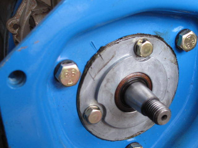

Below is How Jones6780 made a witness mark before removing the injector pump, I am taking the liberty and post his picture here. Jones please correct if I am wrong.
I never needed to do any work on my injector pump but did put a witness mark with a dremel tool to mark pump location in regards to back of timing cover. looks to me pump can be rotated a few degrees.
Looks to me be rotated a few degrees there. Yet to figure out where the shims are and what exactly they do!

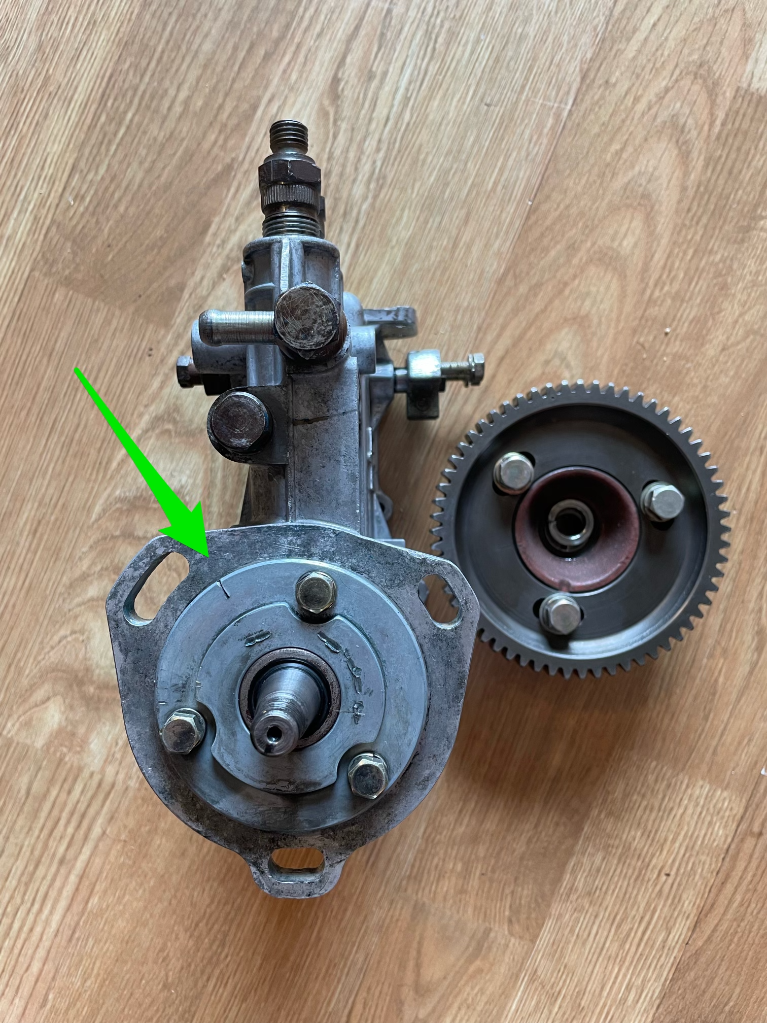

It appears the previous owner of this pump created a witness mark also (see pict). This tractor I have had no pump so .... but maybe when this is all said and running I can put the other half of the mark on this timing cover.

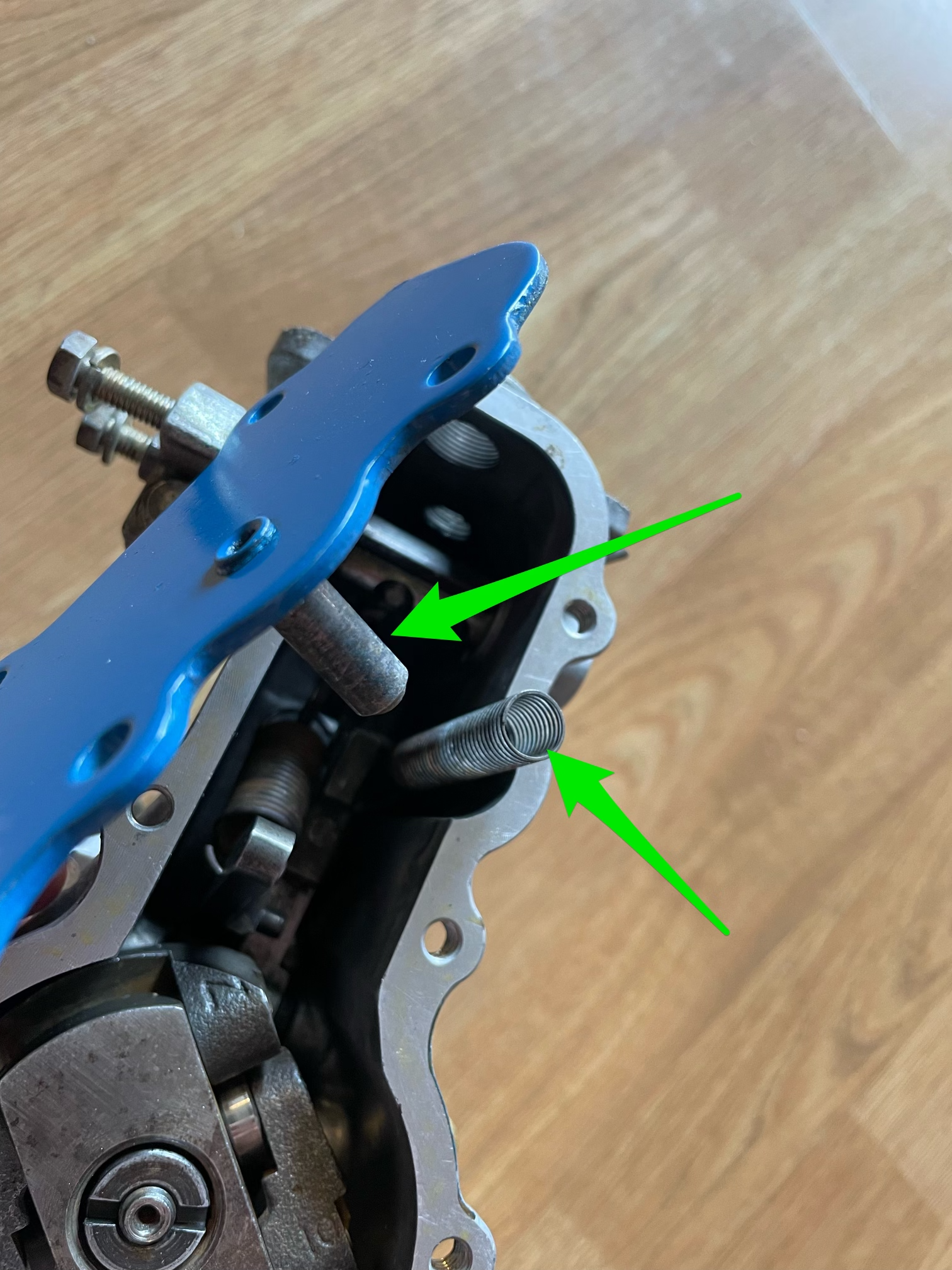

And I think the shim and spring Mike is talking about is this one (see pict) ... it appears the spring just puts pressure back to the idle position? And I am guessing the shims would be added to adjust that pressure ?
