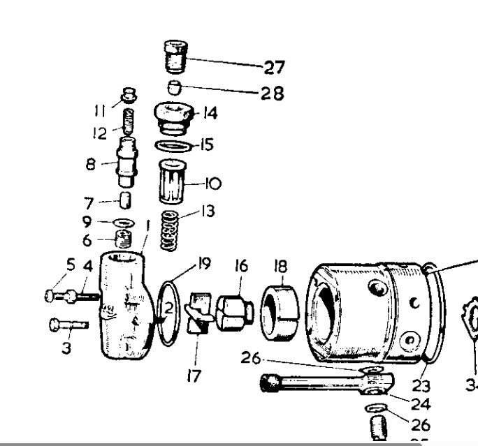

That wasn't the problem. It's getting fuel to the injectors but just not enough. There is a small cylinder plunger that goes in the return, Does it need to move freely inside inside it's housing because I have to tap it out . It's part #7 in the diagram and it goes inside part #8

   / Ford 3600 Injector Pump Isn't Pumping #6
Yes, it’s supposed to move freely..
(Transfer pump piston)
Be sure to put the regulator plug, short side down.. (it just sits on the regulator sleeve)
What part # is that in the diagram?
   / Ford 3600 Injector Pump Isn't Pumping #8
How many other parts in the diagram fit on top of the regulator.??
   / Ford 3600 Injector Pump Isn't Pumping #9
Plungers are stuck inside the pump. You have to completely disassemble the pump to get to them. They must go back into the same holes they come out of. There is 4 of them. You have to bang on them to get them unstuck.
