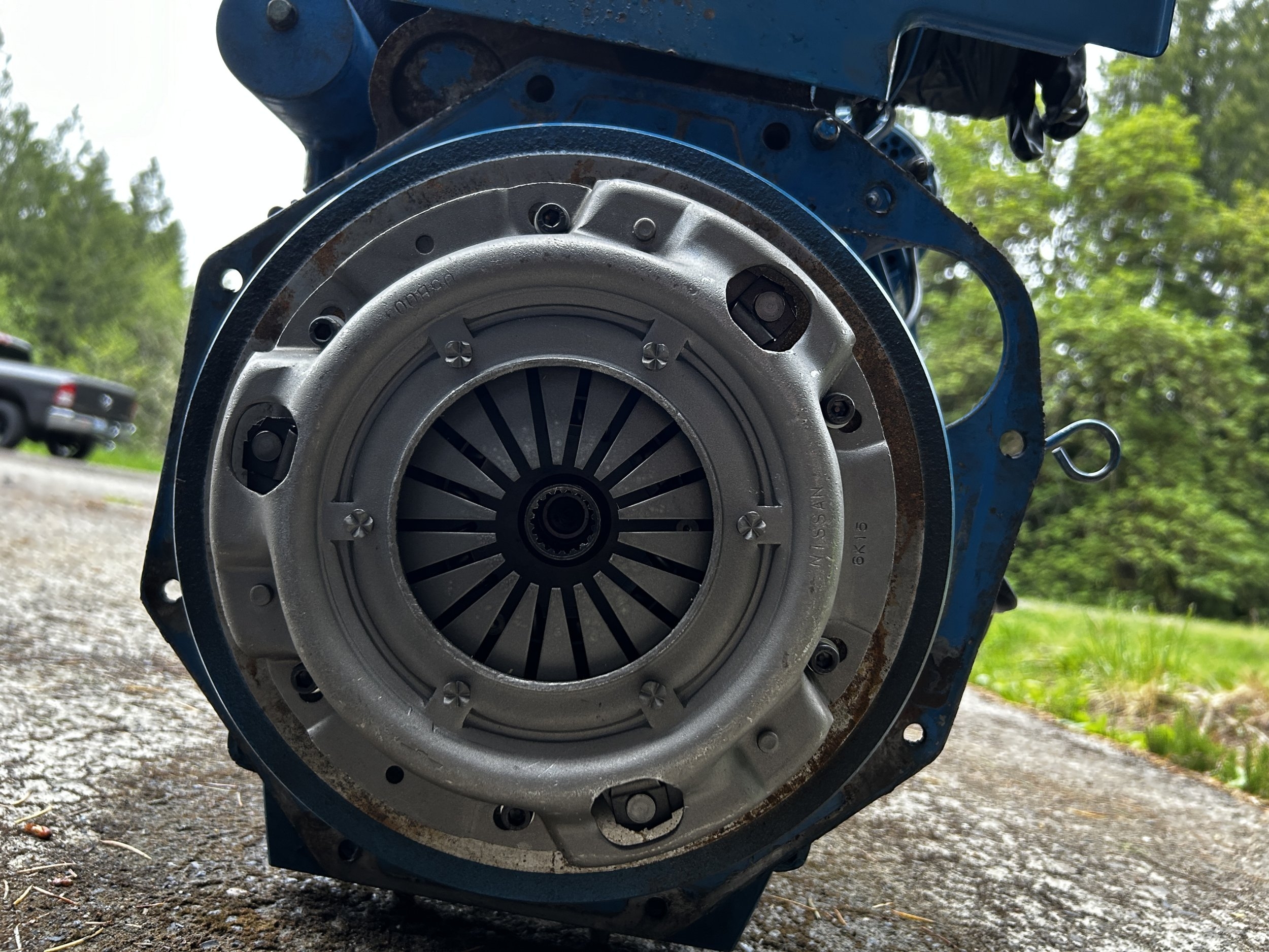

Did anyone get the Nissan pressure plate to work? I just picked up an 1100 with clutch issues. Pressure plate is destroyed for incorrectly installed bearing. I bought the Nissan plate. Should be here this week.
   / Ford 1100 pressure plate update #12

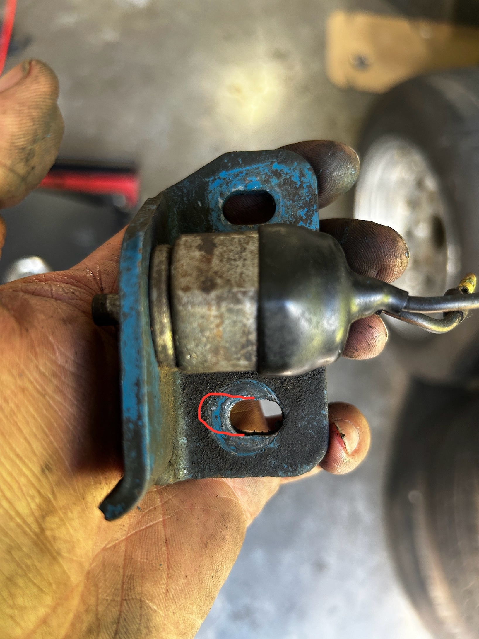

I just put in the Nissan pressure plate and it does work. Had to slightly notch out the mounting/adjustment hole on the clutch pedal stop to get more pedal throw. But it works great now. Also had to notch the pressure plate mount holes. They were slightly different.
