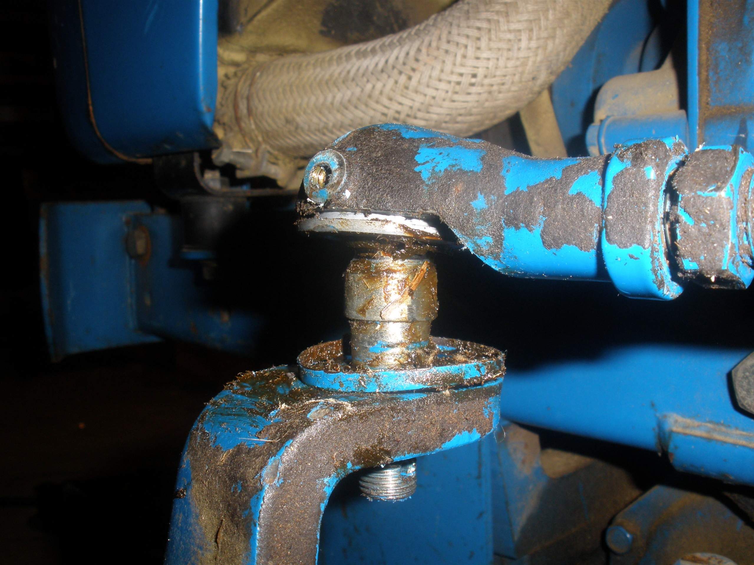

Ok TB, here ya go. Two images of the tie rod with boot removed. Also a pic of my tractor (Ford 1100 4wd, 590 hours, 1983). Jim, the boot was deteriorated, so I have a new one to put on once I get this thing off. You can see I have the castle nut off already. Is that the locknut you are referring to? Thanks for all the help!
View from front...I have removed the castle nut

In your first pic, put your finger on the threads, then slide it vertical up. First thing it touches is the steering arm. The taper on the tie rod end goes into the arm, larger portion of the taper is at the top. Place a 3# hammer head against the side of the arm away from the camera, then smack the side toward the camera with a 2# hammer. Next thing you know, the tie rod end will jump free and you can replace it. Always works. As before, count exposed threads on old unit so new one goes in same depth. You can use the hammer trick, lighter hits, on the tube the tie rod end threads into. Those threads are fine and may be slightly rusted. A few taps around and some PB Blaster can help you start it moving.

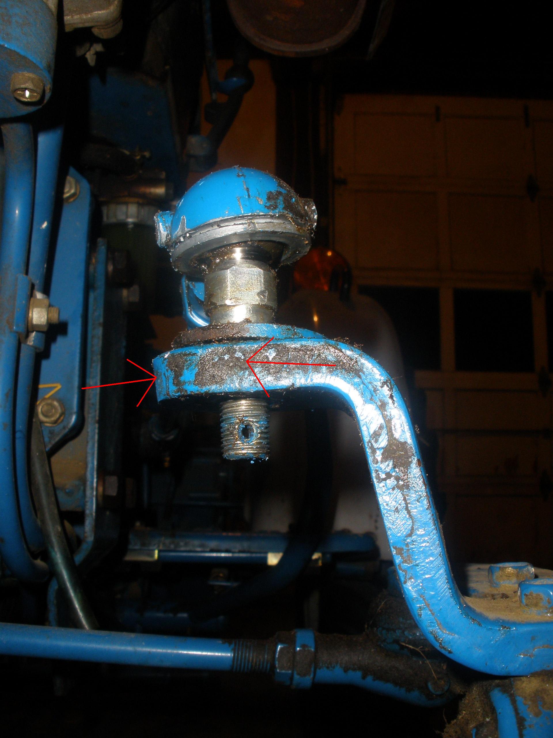

Ok jrccih, I put some arrows where you shoud hit it. It usually works best hitting it on the outside (arrow on left), but you could also hit it where the other arrow is if needed. Jimmy is right, it should pop out easily. The arm is a little thin, you might want to back up the opposite side you hit with a sledge, or something heavier than whatever hammer you use. You may have to turn the wheel to gain a straight on shot with the hammer, or take the wheel off. Good luck! TB Oh by they way, nice little tractor you have there.

Texas Blues....it worked like a charm! Perfect! Popped right out, no problem. Thanks. Much thanks to Jim also, and to others who posted with suggestions.
