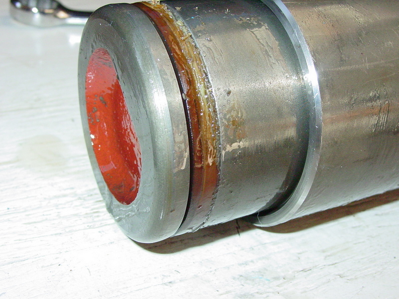

Hi all,
I'm back after a long hiatus. My gear drive 1210 that I use for moving snow has an issue. The lift arms will lower fairly quickly after shutting it off. The heavier the implement the faster it goes.
After some searching, it appears I need to replace a piston seal. I have looked at numerous posts from expert JC Jetro and I am a little confused. Do I access this seal from the rabbit / turtle valve or do I remove the seat and go in from here?
Any pictures and advice would be welcome. We might get some snow in southern Kansas this year!
Thanks in advance.

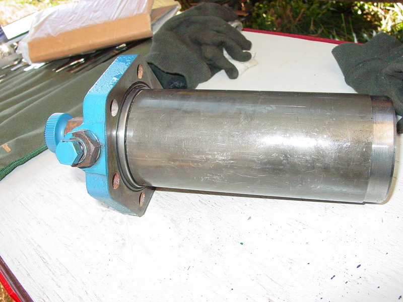

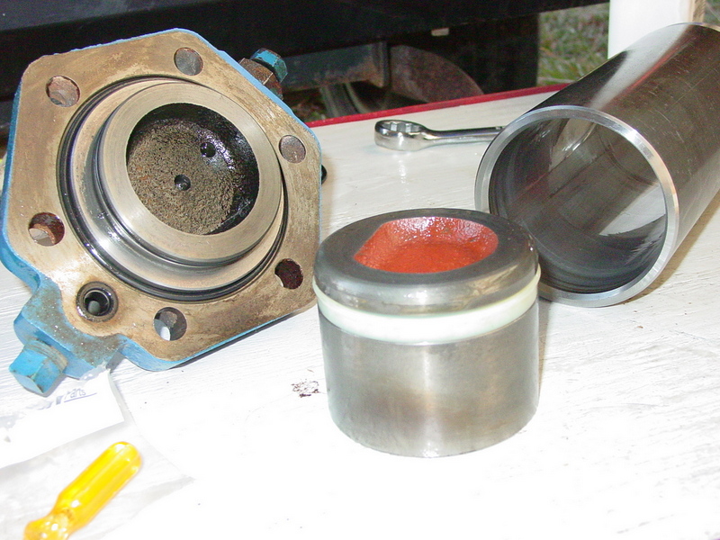

Hi Sld,
I beg to differ on "expert" designation...that's a big shoe to fill.:D
Since you are able to keep the load up on 3 point while engine is on then for sure your pump is fine which is good. Most probably your seal is bad. There is an over pressure check valve that might be leaking passed the rabbit/turtle valve that is highly unlikely. The good thing is this is very simple procedure as you can remove the lift cylinder sleeve with piston along with cylinder head by removing the 6 bolts where the rate of drop needle valve is (aka, rabbit/turtle) knob. There is an o-ring that seal the head to the sleeve, be gentle with it so you do not have to replace it. The piston seal is nylon and not too flexible so do make sure the orientation of is correct when you slide it in the piston groove. It is a double lipped seal and the lips shroud face the front or the cylinder head to fully seal the oil making pressure. I have a few pics here. let me know if you need more clarification. it really should be done in less than one hr with normal tools. You do not need to mess with the seat and lift piston cover unlike many other tractors. Much superior design with the exception of 2 lift cylinder externally attached to the 3-point arms.

Thanks for the reply and that does make sense. Do I need to drain any hyd fluid before doing this?
   / Ford 1210 Hydraulic Leak Down #4
I've read many of your posts over the years. I would say you are an expert on the 00 and 10 series.
No, you do not need to drain any fluid as this thing is higher than any part of of your hyd system an they all drain back to diffy. if you had no leak in the seal then you would have some trapped pressure and bit of oil to squirt out when you open the head. For good measure release all trapped pressure if you have a loader and lower the lift lever down to bleed any trapped oil back to diffy. You will need some rags to clean up a bit of oil here and there. Have you acquired the seal yet?
